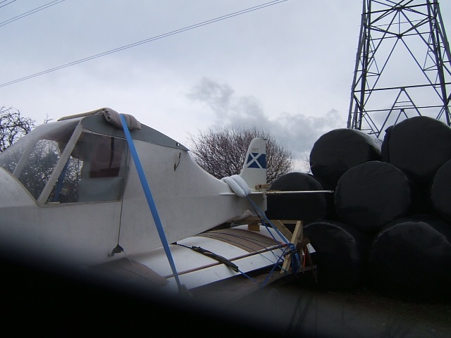

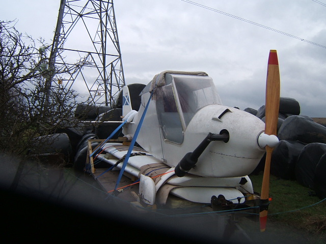

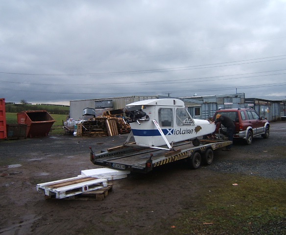

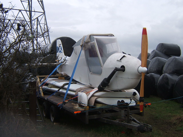

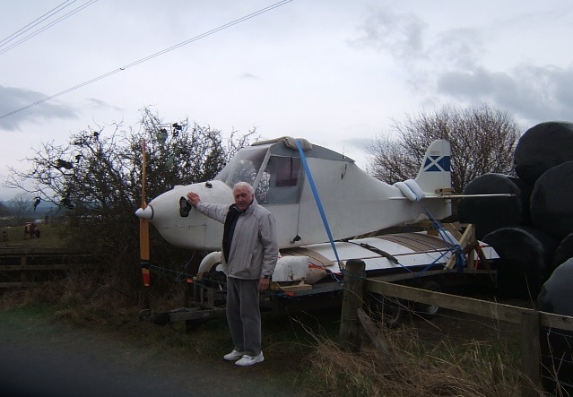

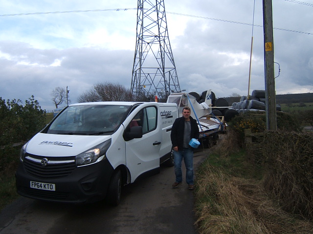

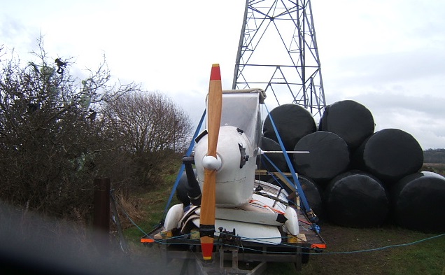

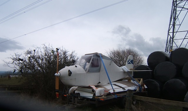

The Iolaire getting loaded in Fenwick Scotland on 4th March 2017 for dispatching to an Irish Location.

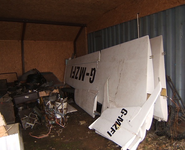

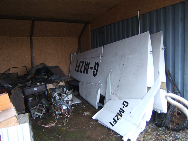

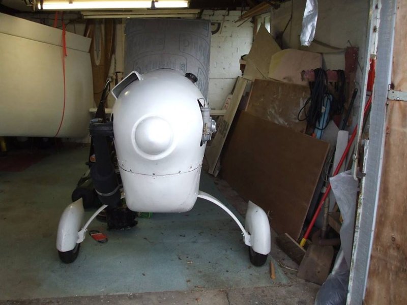

The Wings & Rudders of the Iolaire

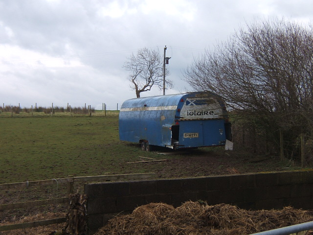

This was the Trailer that the Quaich was kept in ( even though it says Iolaire ) DSCF9684.JPG.d27169d40a824c7b8330570d884e93bf.JPG

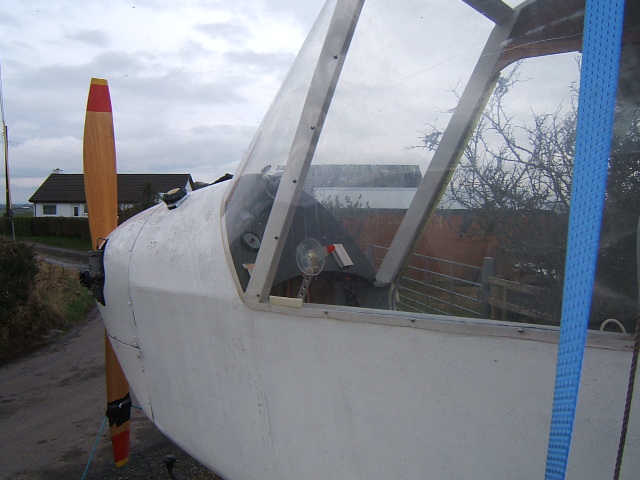

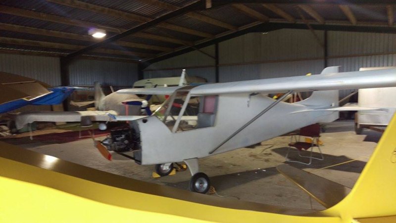

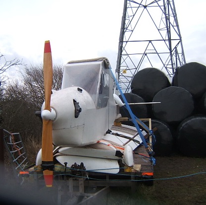

The Quaich loaded on the 3rd March 2017 for a trip down South to be readied for Flight ;-) DSCF9689.JPG.add8cf6494de1d27fa528c9e21ef44b5.JPG

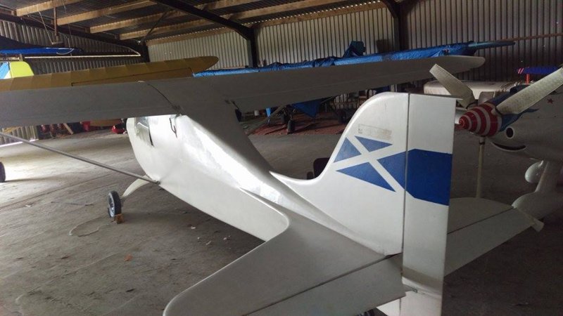

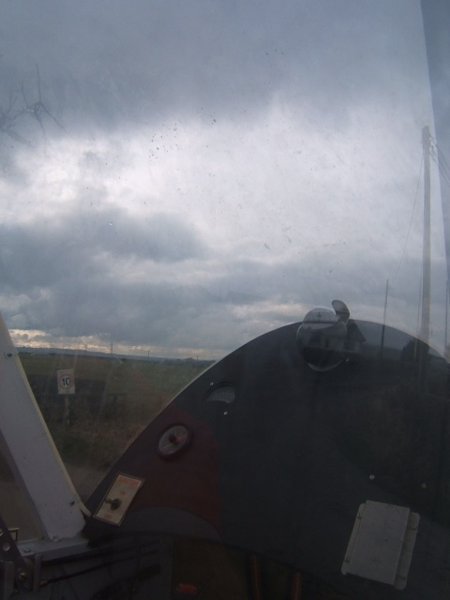

The Quaich G-CKFW taxying around during Ground Handling Tests 05/04/2017We have found it Weathercocks in a 10mph Crosswind, so further checks of the Tailwheel & Rudder are needed to hopefully eradicate the uncontrollable swing !!!!
Further Taxying Tests were conducted when the windsock was almost limp ;-) The handling was better in low wind conditions, we have concluded that the elevator & rudder are not big enough so that will be looked at and refabrication will be happening.
The latest video of the taxying is attached.
Quaich Progress Report,
The Quaich is without any doubt a SSDR Project that is showing up areas that we certainly need to upgrade/update or generally change.
Throughout the Testing Programme we are looking back through all the posts on here because the input from messages are certainly relevant in certain aspects that we are testing on the Quaich.
One area that ' Head in the Clouds ' highlighted was that He thought the Rudder & Elevator areas weren't big enough !!!!!
Initially we disregarded this as we have every confidence in the initial build, we have now found that the Rudder Area definitely needs to be made BIGGER as the rudder authority is non existent below 10kts and a swing into wind happens whenever there is any side wind above 5kts !!!!!
The Elevator seems to be powerful enough to lift the tail at 15-20mph, however we will probably fabricate a larger elevator and try it out.

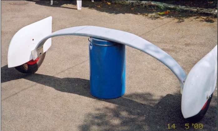

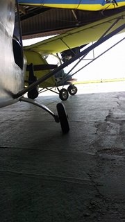

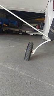

Another area we are looking at now is Undercarriage integrity : After all the Ground Taxying Tests we have now noticed that the wheels are now splayed out !!!
The Taxying tests were undertaken on a slightly undulating runway in Devon and until we do a full stripdown of the wheels etc we aren't sure whether it is wheel bearings that have uniformly failed ( highly unlikely ) or whether the Undercarriage structure has bowed outwards ( this is more likely the case !!! )
I am pleased we are finding a lot of glitches before it takes to the air fully, just been taxyed fast with tail up so far, the 447 Rotax is running very sweetly ;-) 2104221133_QUUC.jpg.85be193f4ef7770dd183df675606741c.jpg
Opinions on Undercarriage welcomed.
"Glitches"?If the same person calculated the landing gear as the wings and other structures, I would be quite concerned.
Bexrbetter, The Wings & other Structures were tested to Section S so we have no major concerns there ;-) The Landing Gear has actually spread by a few inches, nothing major and not something that has concerned the LAA Inspector who has checked it for us ;-)
