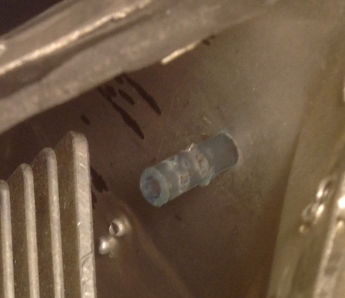

seb7701 Posted August 30, 2016 Author Share Posted August 30, 2016 Yeah, might try an direct the air from running along the roof of the duct from the up swirl just for curiosity sake. Can't remember if I mentioned already, but just for kicks a few weeks back, I taped off both intakes completely and made a smal slit in each and poked the compressor nozzle in there to see where the air was exiting. On the cool side, air was exiting noticeably from down between there cylinders (perfect right?) while on the other side, it was shooting straight to the rear and out the back between duct/fins. Even after I taped off the gap (there is about 3mm more gap on hot side between duct/fins at the rear..) it was finding it's way straight out between the fins on no.4. I know this doesn't take into account the drawing effect from the lower cowl, but we'd see what happens with the manometer. It seems the laws of physics operate differently between each of my bloody ducts!!! 1 Link to comment Share on other sites More sharing options...

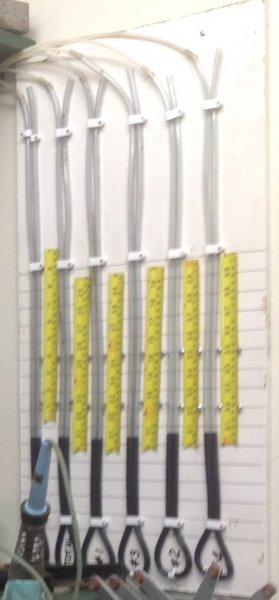

Oscar Posted August 31, 2016 Share Posted August 31, 2016 Seb, re the tube for the manometer: you might find that the clear vacuum tube used in milking machines could work. It looks like the standard Bunnings Aerospace clear tube but it has decent anti-collapse properties - not that you need that per se, but it MIGHT be useful if you're running from under the cowl down out the exit duct and back up into the cockpit via a footwell intake (which is how they did it on the early Jab. testing!) There is a place in Toowoomba that sells it, is a farmer's supply-type shop. Link to comment Share on other sites More sharing options...

Old Koreelah Posted August 31, 2016 Share Posted August 31, 2016 ...for the manometer: you might find that the clear vacuum tube used in milking machines could work. It looks like the standard Bunnings Aerospace clear tube but it has decent anti-collapse properties - not that you need that per se... I got away with using ordinary vinyl tube (about biro diameter) from Mitre 10. It also copes with petrol and all sorts of nasties. I went to quite some trouble to find the best coloured fluid (metho with food colouring) and set up my Guage out of the way behind my right boot. It turns out to be a stupid place; I have to be a contortionist to see it in flight and my little camera finds that all sorts of things get in the way of a good pic. It'll be relocated between my feet where I can more easily see it. At Dafydd's suggestion, to avoid a pitot effect I used a small soldering iron to melt little holes near each end. One thing I'm hazy about though is plumbing the tube. Mine taps the higher pressure air above the heads (inside the ram air duct) and the other end vents in the low pressure cowl flap exhaust area. That probably means I'm getting a bigger pressure differential than the ones in Dafydd's test cell, which vent inside the control room. At the end of my first test flight the fluid had been sucked out and stained the inside of the exit. Probably means I'm getting enough low pressure, but I'd like to actually get a reading at different speeds and cowl flap settings. (This post was delayed by an earthquake at 1322...Windows rattled for about 5 seconds. A phone call confirmed a blast at Werris Ck mine, 16km away.) 1 Link to comment Share on other sites More sharing options...

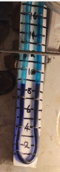

Jaba-who Posted August 31, 2016 Share Posted August 31, 2016 [ATTACH=full]45487[/ATTACH] [ATTACH=full]45488[/ATTACH] I got away with using ordinary vinyl tube (about biro diameter) from Mitre 10. It also copes with petrol and all sorts of nasties. I went to quite some trouble to find the best coloured fluid (metho with food colouring) and set up my Guage out of the way behind my right boot. It turns out to be a stupid place; I have to be a contortionist to see it in flight and my little camera finds that all sorts of things get in the way of a good pic. It'll be relocated between my feet where I can more easily see it. At Dafydd's suggestion, to avoid a pitot effect I used a small soldering iron to melt little holes near each end. One thing I'm hazy about though is plumbing the tube. Mine taps the higher pressure air above the heads (inside the ram air duct) and the other end vents in the low pressure cowl flap exhaust area. That probably means I'm getting a bigger pressure differential than the ones in Dafydd's test cell, which vent inside the control room. At the end of my first test flight the fluid had been sucked out and stained the inside of the exit. Probably means I'm getting enough low pressure, but I'd like to actually get a reading at different speeds and cowl flap settings. (This post was delayed by an earthquake at 1322...Windows rattled for about 5 seconds. A phone call confirmed a blast at Werris Ck mine, 16km away.) A couple of questions. I think I'm at the point of needing to make a manometer as well. 1. Why metho ( as opposed to eg. water) and if so what's the weight of metho? So far all the measurements I've read that it should reach about 2 - 2 1/2 inches difference ( were in inches of water ( so I'd need a conversion for the weight of metho.) And the second question is about the holes made in the tube end with a soldering iron. I'm having trouble envisioning what and where the holes are and how they achieve an anti-siphon effect. Can you explain. On a second issue ( and maybe confirmed with that PDF about the Europa ) I was speaking to Jamie Cook last week and he said that they had some success ( in equalising egt's) with changing the cowl air inlet naca duct (for the carby intake) to a simple flat 2 1/4 inch circular hole. So that is my plan for this weekend. He suggested I try it at the current site and if it helps he had some measurements of where they got it to site best. Now that article seems to perhaps explain why it might work. A flat hole will I assume have less efficient air entry and maybe even have a Venturi effect so turn it into a less positive air pressure down the tube. Maybe??? I'll try it this weekend and report back next week. 1 1 Link to comment Share on other sites More sharing options...
Oscar Posted August 31, 2016 Share Posted August 31, 2016 OK - the manometer tubes in the test cell only measure the air delivery pressure to the heads from the 'squid', for the purpose of tuning the individual head air delivery - not the p-delta, because the test cell doesn't replicate 'installation'. (not meant to, for the specified engine tests: as a result of the tests, the engine manufacturer sets the various limits for operation and it's up to the aircraft manufacturer (or builder) to derive an installation and operational limits for that installation that keep the engine within those limits). One of the interesting things we found when test running my engine, was that with the sump exposed to the full prop blast, there was overcooling of the engine oil. Since we had oil temp gauges both in the normal (bottom of sump) position AND in the line to the oil cooler (for control purposes, as some tests require running the oil very hot indeed for periods to see what the sensible temp. limit is), we could verify that happening - we had to wrap the sump in foam insulation to get the O/T to sensible! In a normal Jab installation, Rod designed the oil cooler to exit its air over the sump, but would have found that without the prop blast, the sump is not very effective at all; what happens is that there is enough cooling from the sump to have a boundary layer of cool oil but beyond that, the oil is hot and thin and that's what gets recirculated. The standard Jab. O/T probe at the bottom of the sump really is NOT measuring the temp. of the oil circulating through the engine, but the temp. of the oil sitting in the bottom of the sump... (another good reason to use a CAMit TOCA). 1 1 1 Link to comment Share on other sites More sharing options...
Old Koreelah Posted August 31, 2016 Share Posted August 31, 2016 A couple of questions. I think I'm at the point of needing to make a manometer as well.1. Why metho ( as opposed to eg. water) and if so what's the weight of metho? So far all the measurements I've read that it should reach about 2 - 2 1/2 inches difference ( were in inches of water ( so I'd need a conversion for the weight of metho.) And the second question is about the holes made in the tube end with a soldering iron. I'm having trouble envisioning what and where the holes are and how they achieve an anti-siphon effect. Can you explain. On a second issue ( and maybe confirmed with that PDF about the Europa ) I was speaking to Jamie Cook last week and he said that they had some success ( in equalising egt's) with changing the cowl air inlet naca duct (for the carby intake) to a simple flat 2 1/4 inch circular hole. So that is my plan for this weekend. He suggested I try it at the current site and if it helps he had some measurements of where they got it to site best. Now that article seems to perhaps explain why it might work. A flat hole will I assume have less efficient air entry and maybe even have a Venturi effect so turn it into a less positive air pressure down the tube. Maybe??? I'll try it this weekend and report back next week. I used metho with food colouring so I could see it during flight, in the dimly-lit area around my feet. For some reason coloured water kept separating into segments in the tube. No idea of the impact on readings of metho having different density to water, but I'm assuming bugger-all. How the ends of the plastic tube sit in the airstream is important. Facing into the airstream might create a pitot "ram" effect (watch your ASI while someone slips a sealed tube over your pitot.) Facing back could cause a suction effect (like happens with some over-wing fuel vents). Little holes around the ends should nullify such effects. Jaba I'm keen to see how your carby inlet changes work. Today I'm making a start on yet more major surgery to my cowls and the damned NACA duct for the oil cooler (that I wasted weeks on) is going. Trouble is the carby shares that inlet, and more recent reading on NACA ducts say they're not ideal for carby intakes. I am therefore open to design suggestions. Most of the work will happen after I get home from North Qld. I'll be in Cairns next week and plan to look up Frank Farri. Is your Jab at the airport? Link to comment Share on other sites More sharing options...
Jaba-who Posted August 31, 2016 Share Posted August 31, 2016 I used metho with food colouring so I could see it during flight, in the dimly-lit area around my feet. For some reason coloured water kept separating into segments in the tube. No idea of the impact on readings of metho having different density to water, but I'm assuming bugger-all.How the ends of the plastic tube sit in the airstream is important. Facing into the airstream might create a pitot "ram" effect (watch your ASI while someone slips a sealed tube over your pitot.) Facing back could cause a suction effect (like happens with some over-wing fuel vents). Little holes around the ends should nullify such effects. Jaba I'm keen to see how your carby inlet changes work. Today I'm making a start on yet more major surgery to my cowls and the damned NACA duct for the oil cooler (that I wasted weeks on) is going. Trouble is the carby shares that inlet, and more recent reading on NACA ducts say they're not [ATTACH=full]45489[/ATTACH] ideal for carby intakes. I am therefore open to design suggestions. Most of the work will happen after I get home from North Qld. I'll be in Cairns next week and plan to look up Frank Farri. Is your Jab at the airport? Unfortunately no. I used to have it at the Cairns airport for years. Rented a spot in a hangar with a mate who had an EC120 helicopter. But he sold his hangar to Nautilus Helicopters when the airport owners started screwing us all with logarithmic cost increases. There's very few private aircraft left on the field now. I keep it up at Atherton (about an hours drive south west). Farri lives south of Cairns about 45 minutes drive south at Deeral. (Well he used to. I think he's still there. I used to fly my old R22 into his strip quite a lot. ) Sharing an intake there sounds like it might cause trouble - (If the theory on that pdf discussed before is true. Two conflicting requirements - the oil cooler needs positive pressure inflow and the what those guys were saying is the carby requires NOT positive pressure. I'll let you know how it goes. 1 Link to comment Share on other sites More sharing options...
