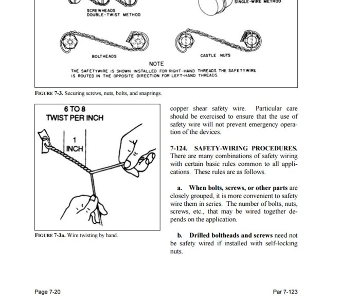

M61A1 Posted January 26, 2017 Share Posted January 26, 2017 how many turns on an inch of lock wire. I must know According to the AC43b (which you really should be aware of if you maintain aircraft) 1 Link to comment Share on other sites More sharing options...
Riley Posted January 26, 2017 Share Posted January 26, 2017 According to the AC43b (which you really should be aware of if you maintain aircraft)[ATTACH=full]47981[/ATTACH] Thanks for that specific and in-arguable lockwiring data. Whilst 'turns-per-inch' wasn't the l/wiring question I was dudded on, your reprint from AC43b clearly shows that there is/was no suggestion anwhere that convoluting three strands of lockwire into a 'braid' or 'plait' is an acceptable aviation standard. The 'braided' or 'plaited' example pictured in the exam question (while correctly threaded to prevent either bolt head backing off) was accompanied by the query "is the example shown, correct for lockwire?" My response in the negative was judged incorrect. Never in 8 years on the tools as a trained AE tech in the RCAF and nearly 50 years of subsequent tinkering with aircraft anywhere in the world have I seen safety-wiring done in the manner that RAA/CASA/Canvas apparently reckon is acceptable. Hopefully this 'bad' example will be eliminated from the testing of a layman's understanding of home maintenance under L-1 authority. cheers riley Link to comment Share on other sites More sharing options...
facthunter Posted January 26, 2017 Share Posted January 26, 2017 Since there are at least 2 different thicknesses of wire used, I would suggest the thicker gauge would have less turns for any specific distance. If you do them with the "TOOL" It's usually going to be more even. There will often be (fiddly) bits you do by hand and if you pull one side tight(er) the other will just tend to spiral around it and has no grip to speak of.. At one end this could have it fly apart particularly in rotating situations like prop hubs. TAB(bed) washers can be very satisfactory. I've seen split pins in conrods wear through and fall out. Nev Link to comment Share on other sites More sharing options...
biggles Posted January 26, 2017 Share Posted January 26, 2017 Thanks for that specific and in-arguable lockwiring data. Whilst 'turns-per-inch' wasn't the l/wiring question I was dudded on, your reprint from AC43b clearly shows that there is/was no suggestion anwhere that convoluting three strands of lockwire into a 'braid' or 'plait' is an acceptable aviation standard. The 'braided' or 'plaited' example pictured in the exam question (while correctly threaded to prevent either bolt head backing off) was accompanied by the query "is the example shown, correct for lockwire?" My response in the negative was judged incorrect. Never in 8 years on the tools as a trained AE tech in the RCAF and nearly 50 years of subsequent tinkering with aircraft anywhere in the world have I seen safety-wiring done in the manner that RAA/CASA/Canvas apparently reckon is acceptable. Hopefully this 'bad' example will be eliminated from the testing of a layman's understanding of home maintenance under L-1 authority. cheers riley Bob , I'm so glad to read your post as I was also marked as wrong on the same question, for precisely the same reason as you , but don't have the fight in me these days and thought, " well I've passed anyway so, what the heck". I've been waiting for some authoritative comment on that question .... Bob Link to comment Share on other sites More sharing options...
