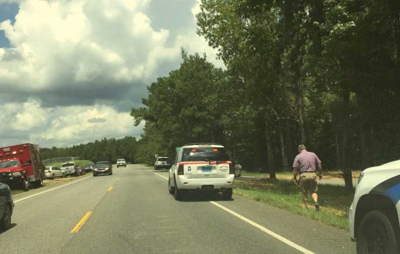

Guest SrPilot Posted August 14, 2016 Share Posted August 14, 2016 As I was nearing my hangar this morning I noticed a large column of black smoke coming up from behind the trees just off the departure end of runway 12 at KTCL. I thought someone was burning tires. Unfortunately, a transit airplane had just impacted off the runway. The news is still developing. First reports I received from a law enforcement agency was 5 fatalities. A source on the airport says 7. One TV news report, quoting an official, says 6. [red dot on airport diagram is my hangar] Crash site in trees to right of road abeam the red emergency vehicle. Initial indications are that the airplane was a Piper Navajo with 5-7 persons on board. They were attempting a landings and "didn't make the runway." The impact was maybe 300-400 meters from the end of runway 30, but that would have been a downwind landing. They could have been attempting a close-in left base to runway 22 but that would have been tight. So far, officials aren't commenting. One person at the airport told me they were reporting an engine problem. More forthcoming as information becomes public. BREAKING: Plane crashes in Tuscaloosa County, multiple fatalities reported Sunday, August 14th 2016, 1:05 pm CDTSunday, August 14th 2016, 1:05 pm CDT By Ty Watwood, Executive Producer NORTHPORT, AL (WBRC) - A small plane crashed Sunday in Tuscaloosa County, killing as many as 6 people, according to Northport Fire Chief Bart Marshal. Chief Marshal says there was a small fire that was extinguished. Marshal says it appears no one survived. WBRC FOX6 News has multiple crews heading to the scene. This is a developing story. Check back for updates. Link to comment Share on other sites More sharing options...
