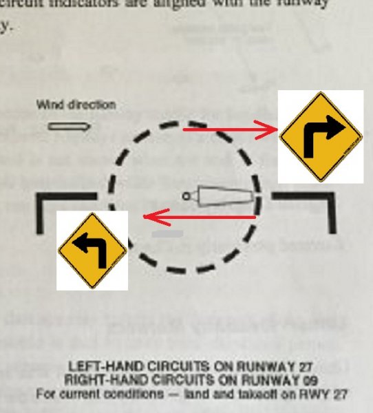

Parkway Posted August 23, 2016 Share Posted August 23, 2016 So I don't think we use these very often here in Australia, but it's still in the study material.. Anyway these two diagrams seem to contradict each other, wondering which is correct? I thought that the "L" indicates the base and final segment, like it seems to be represented in the diagram on the right. But on the left diagram that would mean both runways would be right Hand circuits but the caption says left hand circuits? Confused Link to comment Share on other sites More sharing options...

CAV0K Posted August 23, 2016 Share Posted August 23, 2016 Look at it as the upwind and crosswind leg .. that way all CCTS are LH on the left diagram. Hope this helps 1 Link to comment Share on other sites More sharing options...
Happyflyer Posted August 23, 2016 Share Posted August 23, 2016 As stated above. The 'L' represents upwind and crosswind. Link to comment Share on other sites More sharing options...
Parkway Posted August 23, 2016 Author Share Posted August 23, 2016 Oh yeah. Really obvious. Don't know why I had it in my head that they represented base and final. Thanks guys, feeling kinda dumb hahaha 1 Link to comment Share on other sites More sharing options...
Nightmare Posted August 23, 2016 Share Posted August 23, 2016 You can also think of it as the pointy bits are pointing to the live side Link to comment Share on other sites More sharing options...
red750 Posted August 23, 2016 Share Posted August 23, 2016 Interpret them like roadside turn signs. If taking off in the direction of the top red arrow, it's a right turn, therefore, right circuit. If taking off in the direction of the lower red arrow, it's a left turn, therefore, left circuit. 2 1 Link to comment Share on other sites More sharing options...
CAV0K Posted August 23, 2016 Share Posted August 23, 2016 Oh yeah. Really obvious. Don't know why I had it in my head that they represented base and final. Thanks guys, feeling kinda dumb hahaha Glad we could help! Don't feel dumb, we as pilots are always learning. At least you took the initiative to ask for clarification of something you were unsure of. Good luck with your study. 1 Link to comment Share on other sites More sharing options...
DWF Posted August 23, 2016 Share Posted August 23, 2016 Has anyone seen this ground signal in use at any airport in Australia? I haven't, and I have been to a fair few of them. Link to comment Share on other sites More sharing options...
ben87r Posted August 23, 2016 Share Posted August 23, 2016 Never seen or herd of them. Don't dislike the idea tho, it's effectiveness would be limited tho. Link to comment Share on other sites More sharing options...
