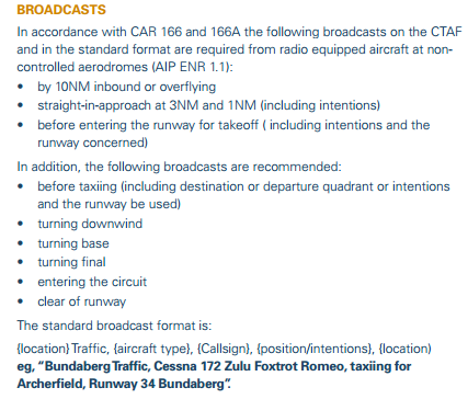

So clear of all runways isn't a required call at non towered airports?
Reading this from casa it seems like there are only recommendations and no hard and fast rules of which calls have to be made.. Probably doesn't help the whole situation of instructors teaching what they think should be done rather than a set guideline of what calls to make
https://www.casa.gov.au/sites/g/files/net351/f/_assets/main/download/caaps/ops/166-1.pdf
So clear of all runways isn't a required call at non towered airports?Reading this from casa it seems like there are only recommendations and no hard and fast rules of which calls have to be made.. Probably doesn't help the whole situation of instructors teaching what they think should be done rather than a set guideline of what calls to make
CAAP 166 is a good start, the table on page 22 lists the recommended broadcasts. Page 22, para 7.3.6 effectively says other calls should be made to avoid the risk of a collision when one exists - this doesn't give permission for teaching verbal diarrhoea. I cannot see how a call clear of the runway serves to avoid a collision. My take on this poor RT use is most flight instructors are now trained at towered airports, so simply transfer those calls on top of the CAR 166 calls.
The AIP Book is the primary source for when and what to say, whether that be Class C, D or G airports. if you're uncertain of the rules, it might be worth reviewing that info.
Remember CASA has started to move in the Public Liability direction; where there is a code or recommendation, your situation is reversed and the code or recommendation becomes your defence against negligence, so in terms of financial self preservation they are tougher than the old prescriptive regulations ever were.

Ok lots of opinions here... I agree with many, but... What is the absolute MANDATORY minimum calls inbound to landing at a basic CTAF? Given that a radio is optional, my pick is NONE! Obviously, that isn't very safe, so flexibility, (governed by traffic density) is the best choice, I would think... Keep it minimum when busy, moderate if nobody around, and LOOK OUT THE WINDOW at all times! Ok, flame me now...048_surrender.gif.737a6283dfb1349140cc8b959302f540.gif
