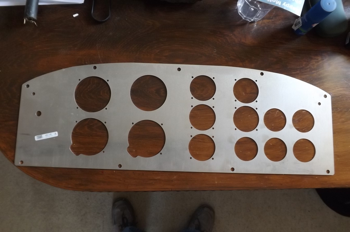

That's standard, Marty, or was end of 2014 when my kit was boxed.
It's all extra weight and bits, but probably takes a lot of the pain out of assembling the panel.
As for the panel layout, there are endless opinions on that. As a relative novice (and something of a luddite) I'm quite happy with the steam gauges for starters.
I will probably cut a hole on the left and put my slip indicator there, so that and the airspeed are right under my nose.
I'm waiting for the day to cool a bit before more painting. It continues to be quite a challenge..........
Link to post
That panel frame is fairly rigid, it's pressed with a sort of rolled edge, on both the outer and inner edges.
I guess it would have to be to hold the shape of the coaming (?) until the panel goes in.
Link to post
Yes, that's where the 701 differs- it's just a single piece bent over with relief flanges.  You're supposed to leave the top coaming un-riveted so you can remove the panel while you get all your instruments in, then rivet it all together.

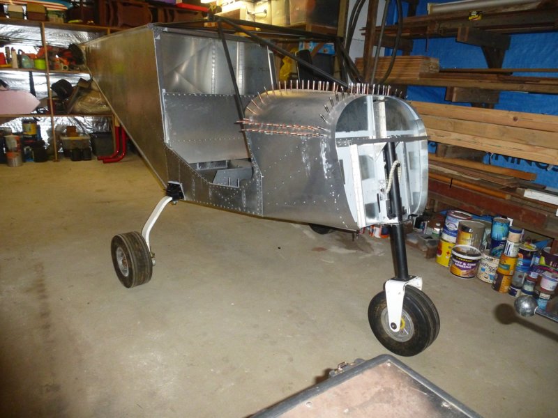

Well, people will be very confused about the taste of my 701.  Savannah maingear, nosewheel, slats, fuel system, control mixer, flap handle, Y-stick and rudder pedals.  Oh, and the elevators are 750-style trailing edge but 701 span, with 750-style inset trim tab.

I hope you will share why you have departed from the standard CH701 and chosen to go with:
1. Savannah main gear?
2. Savannah nose wheel?
3. Savannah slats?
4. Savannah fuel system?
5. Savannah control mixer?
6. Savannah flap handle? *
7. Savannah Y-stick?
8. Savannah rudder pedals?
9. CH750-style trailing edge?
10. CH750-style inset trim tab?
I am really intrigued!!
* I will be fitting a Mark-Kyle manufactured flap handle to my Savannah. This has a better (and safer) operating angle of the flap lever as well as an additional notch.
Link to post
