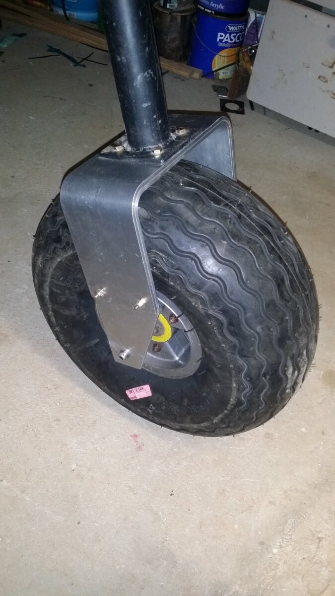

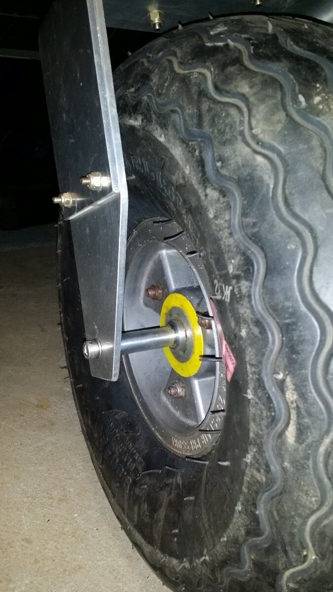

Solved the axle problem - good suggestion @fallowdeer, I bought a Savannah Tundra axle from Peter at Aerokits which is exactly the right size for the big Zenith fork.  I think the bigger donuts look good and it's raised the plane 110mm - prop centreline to ground is now 1150mm, which is 50 more than the plans.

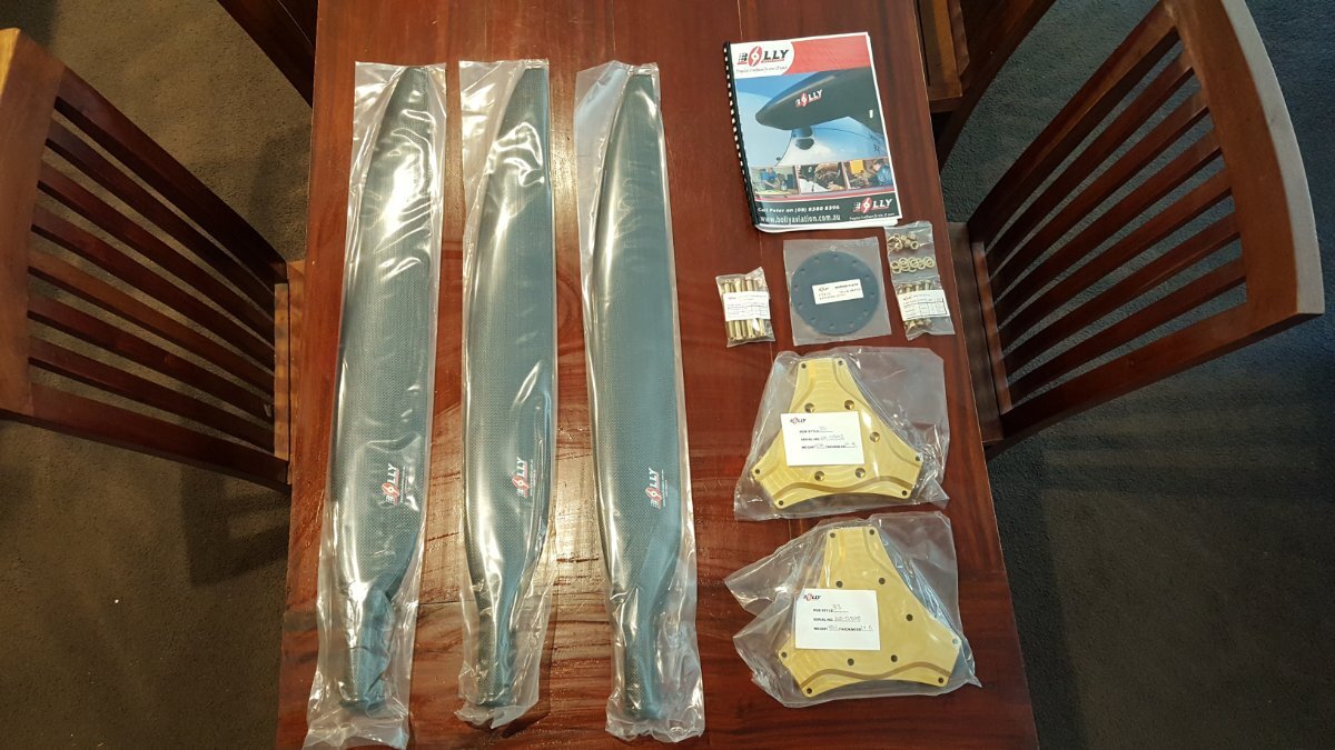

30 minutes ago, nomadpete said:
Wow!
Lucky man!
Happy Birthday!
Gee, that would look great on the front of an aeroplane.
It's back in the box for a while Peter... no point putting it on until I'm ready to adjust it, it'd just suffer hangar rash.
I had to keep them away from the kids... they took one look at the blades and yelled "light sabre practice!!".  Yeah, nah.
  • Haha 1
  • Helpful 1

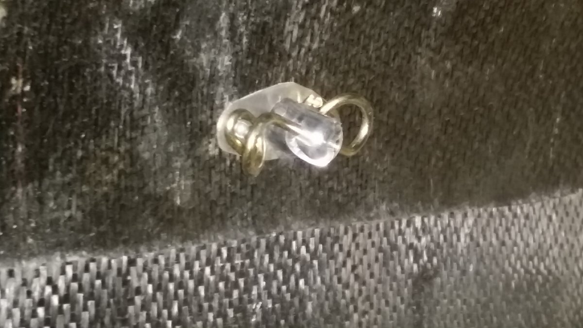

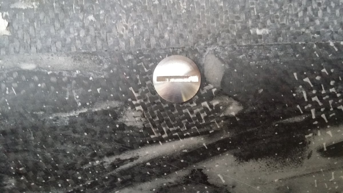

On the suggestion of another builder, I drilled holes for 4 clekos to hold the upper and lower cowl together while fitting and adjusting the Dzus fasteners.
I believe this was to hold the two cowls in exactly the same position while drilling and fitting, so that all the fasteners were identically centered (since individual Dzus fasteners do allow some movement).
This is the only time I have ever fitted them, so I have no feel for what difference that may have made.
28 minutes ago, IBob said:
Belated thought:
I already had it clecoed in all joining positions - around 16-20 I think, so the holes were already in position in 1/8".  I made a guide with 3 holes in the position of the DZUS centre hole and the 2 rivet holes, all 1/8", so I just cleco the guide to the existing holes, drill and countersink the other two, cleco the thin aluminium supports on the outside to guide expanding the middle hole to 10.5mm - then flip them to the inside and rivet them and the spring thingy together.
Then expand the outer cowl's hole to 10.5 as well (using a step drill seemed to work well and keep it centred).
1 hour ago, Marty_d said:
Installed some dzus on the cowl - only got 2 done.  Fiddly but work well, so I'm happy with that.
Hi Marty  The ones I've installed have a small washer over the spring curl to prevent the rivet end becoming loose or the spring clip coming off in time.  Cheers Mike
