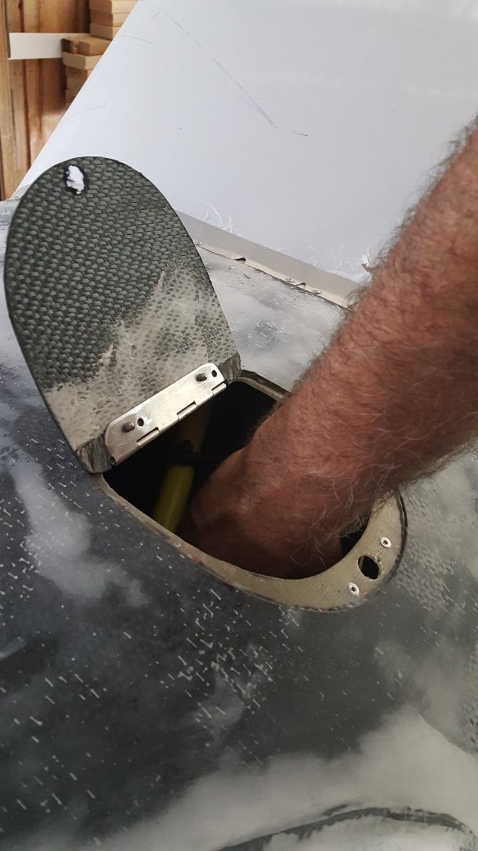

Try cut out in cardboard as you need to get hand in and remove oil can cap with your fingers and thumb holding it.  Any Sav or Skyfox aircraft locally will have a hatch.  My old skyfox had the camloc with the ears on it so did not need a tool to unlock and lock.  Cheers

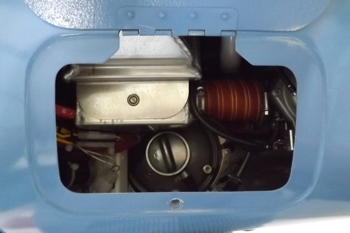

Here ya go Marty. This is on the S,  190mm wide x 105mm deep (IF the recessed lip was carried all the way round. Since it's not, 115mm deep at centre).
Doesn't need to be that wide, I'd guess it's supplied like that to cater for different engines/mounts.
  • Informative 2

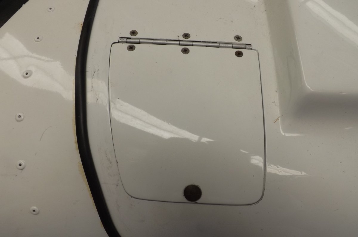

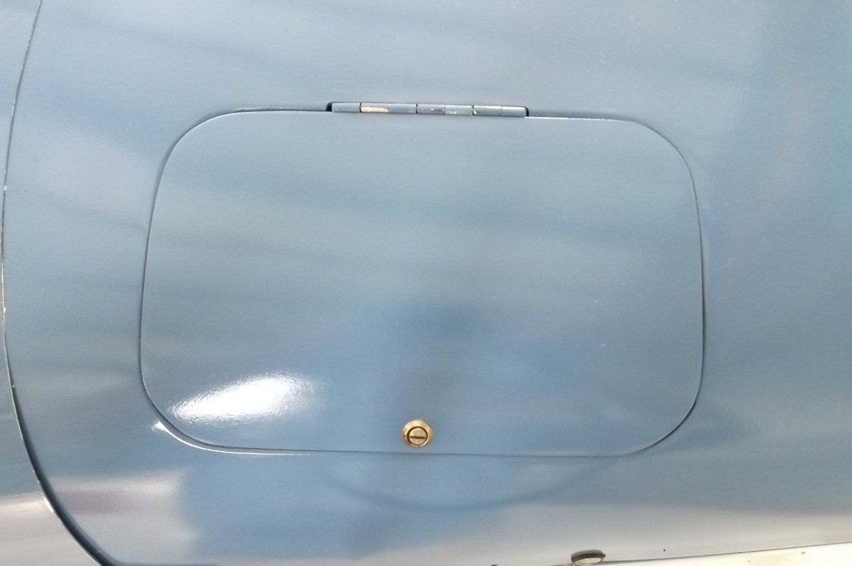

And here is a very tidy DIY hatch on a VG, probably a better fit for you.
100mm wide at the midpoint of the sides, 125 from hinge to fastener side.
(These are the dimensions of the final hole: note this also has an inner lip, so the cover sits down flush).

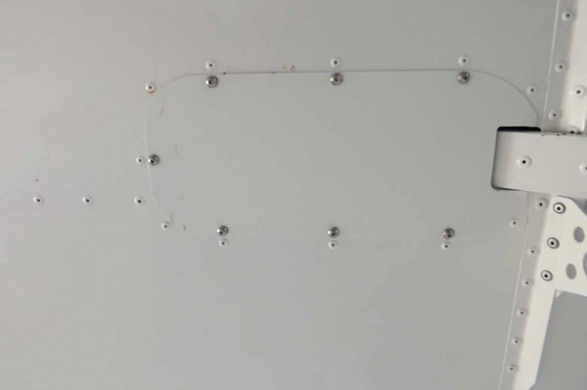

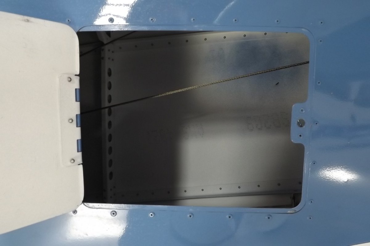

FWIW, for hatches in the 6061 panel, they supply a doubler with a slightly smaller hole, which rivets inside the skin. This stiffens the edges of the skin, and provides a lip so the cover sits flush to the skin.
This is the rear fuselage side hatch, gives access to control cables and used to be where the battery was, you can see the doubler:
And here are the underwing inspection hatches. Again they have a doubler riveted inside. In this case there is no lip and the cover sits on, rather than flush to, the skin, secured by rivnuts and hex head screws.

You can substantially reduce stress points by avoiding sharp radiuses on the corners of the hole you cut - and the doubler is an excellent idea that not only holds the inspection plate flush and secure, it also adds strength to the sheet that has been cut.
If your dipstick top is just under the proposed hatch cover you don't need to get your hand in, just a thumb and  forefinger to undo the dipstick & remove/replace it. I can't remember exactly how big mine is but it is a bit less than 100 x 100. I epoxied a doubler underneath  with a wide end to accommodate the camloc keeper. Works a treat. When I painted it all in situ it was hard to even see it.

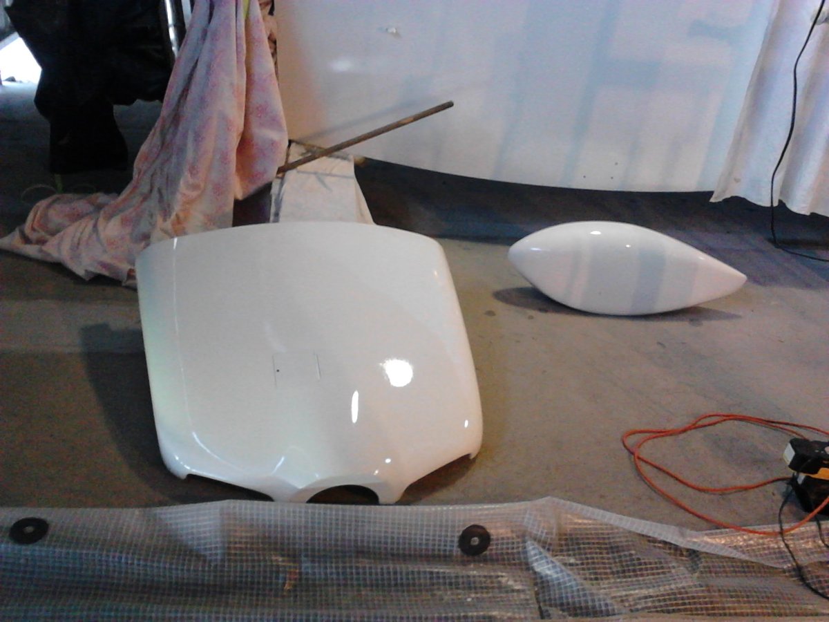

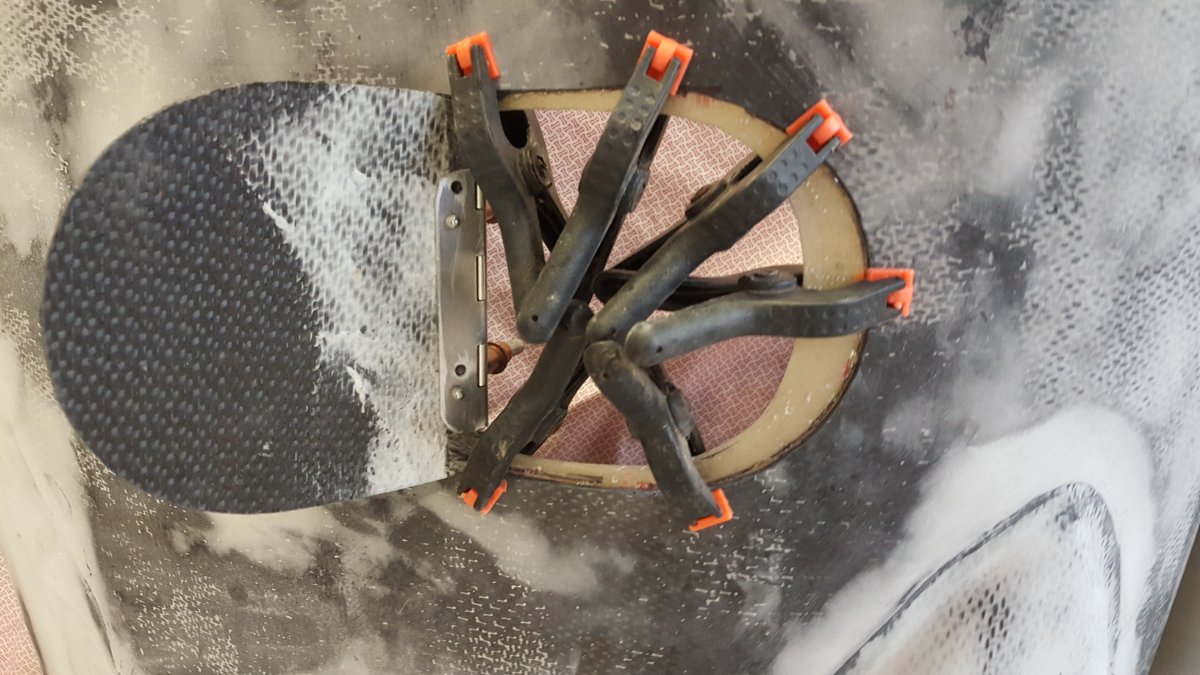

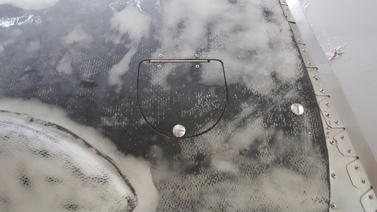

Well, I got the oil hatch done.  Decided to go with the DZUS because otherwise I'd have to carry a different screwdriver for the camloc.  Besides, I had the spare DZUS.
I made the recessed bit out of a section of a "first attempt" fibreglass cowl that the owner of the moulds had given me, so it matched the curvature.  Epoxied that to the underside of my cowl and then hinged the door.
Size seems about right for my arm, especially as a bit of wrestling is needed with the oil tank cap - are they always this tight??

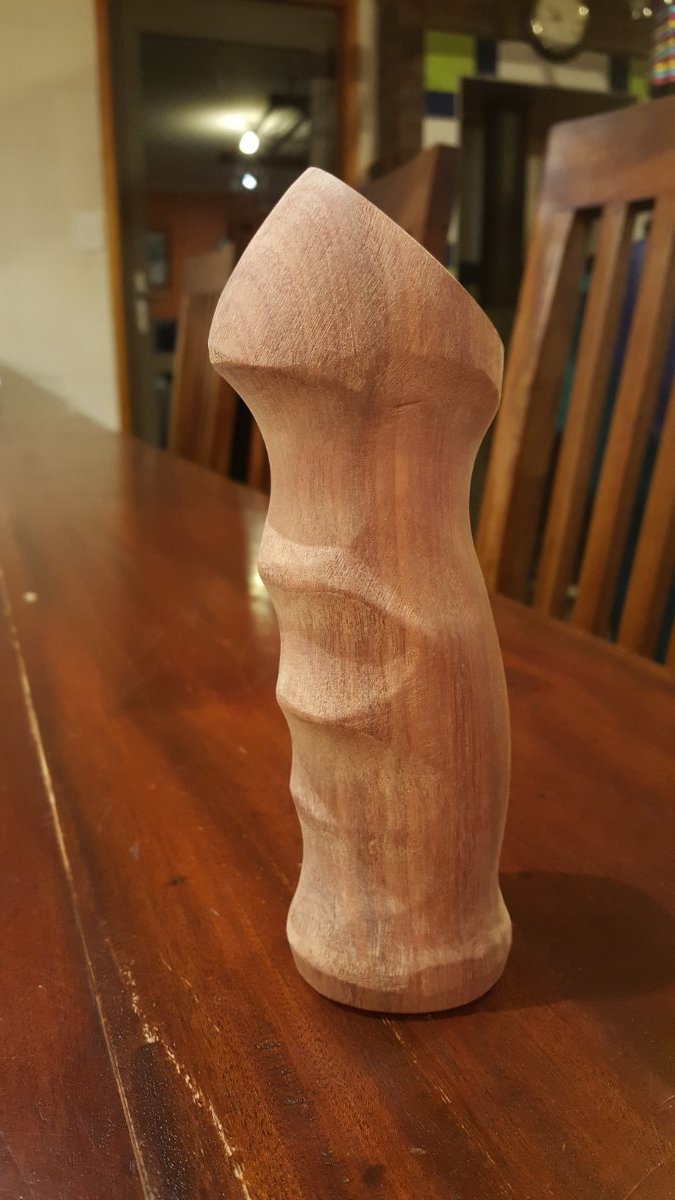

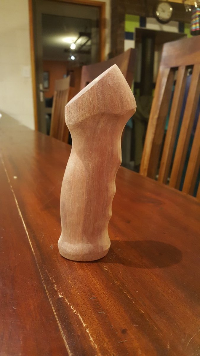

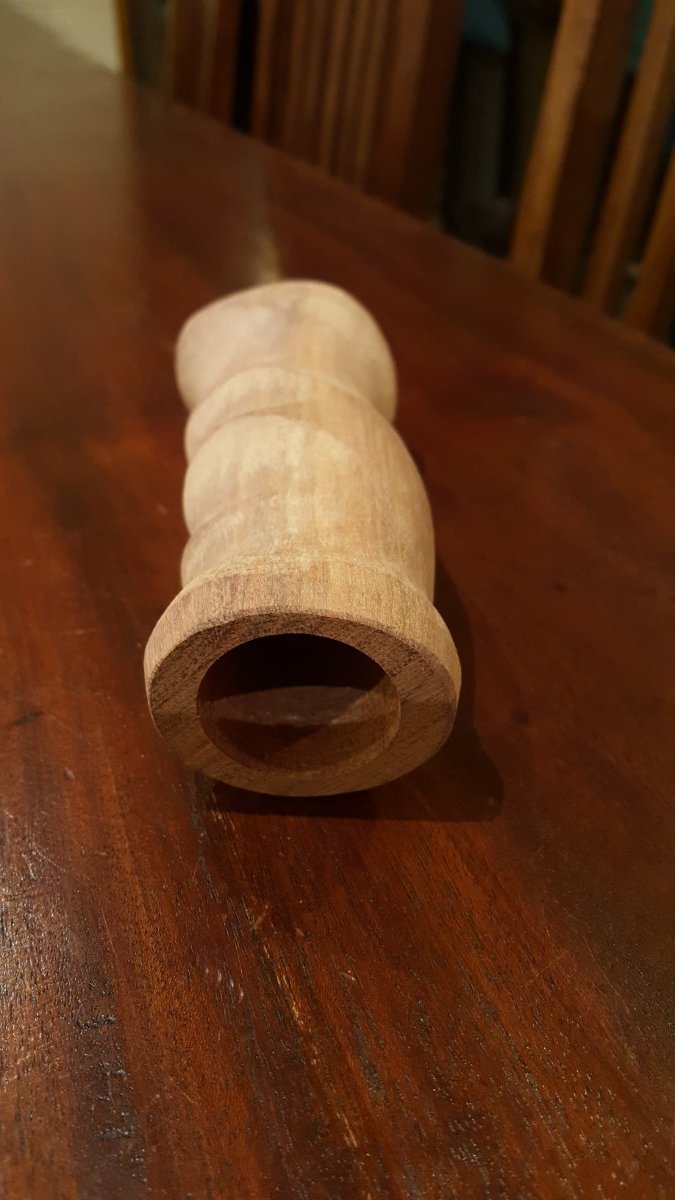

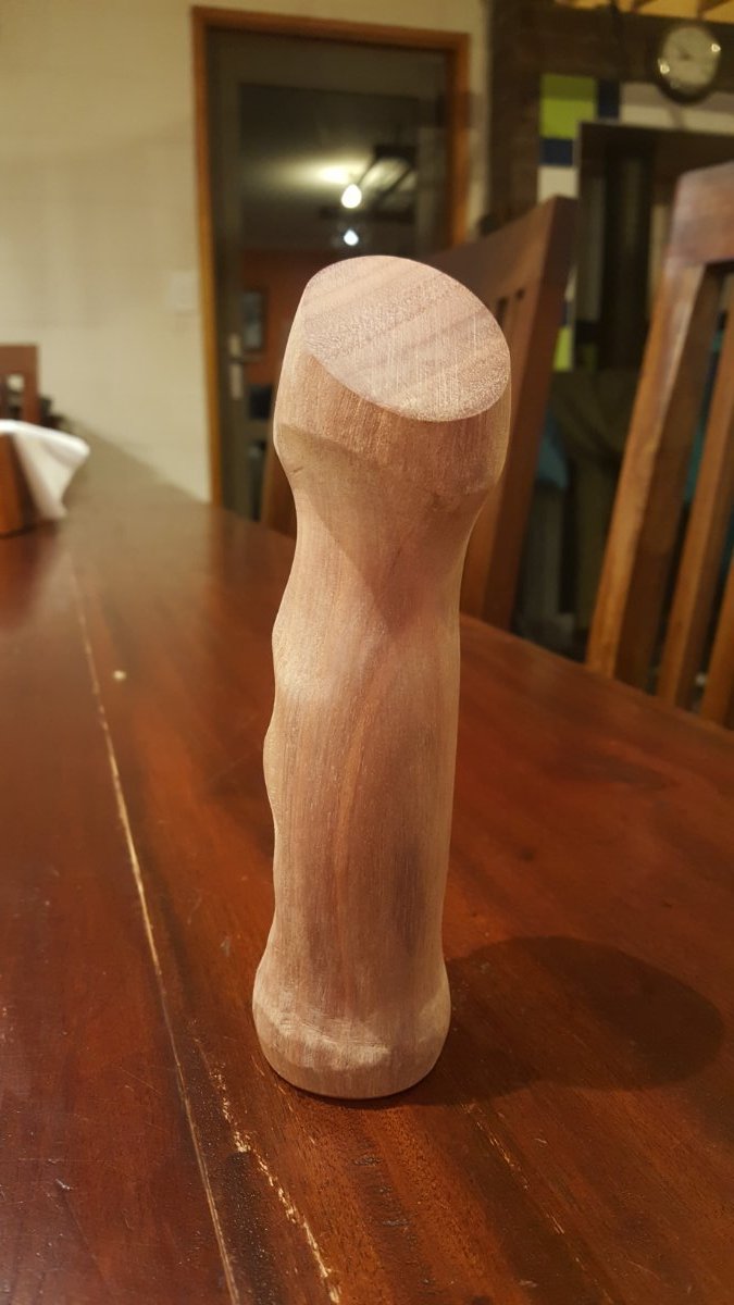

Today I spent a few hours making a wooden grip for the Y-stick (trouble is, now I'll have to make another one!)
I used a bit of scrap hardwood I found in the shed, no idea what it is but I think it'll have a nice reddish shade when I varnish it.
Fits my hand, but makes my wife laugh every time she sees it, for some reason...

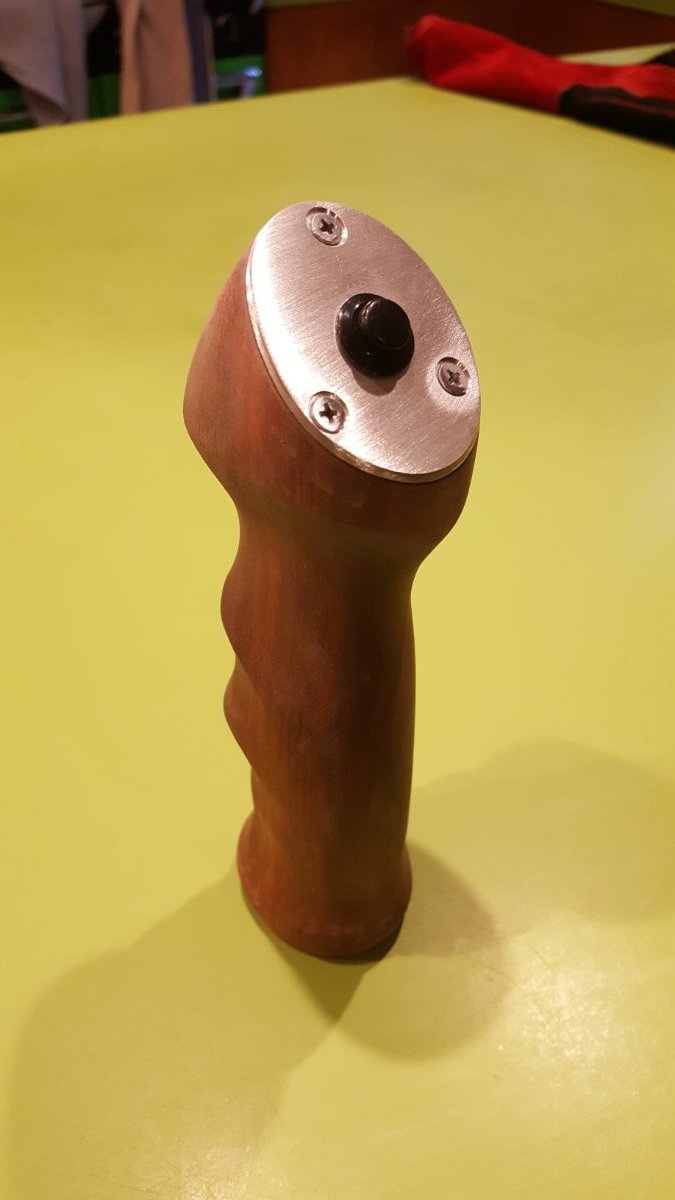

After a couple of false starts I installed the PTT on the dildo, sorry, stick grip.  Tried insetting a smaller aluminium disk into the wood but it didn't work too well, so went with fully covering the end.  I think it works. 20230507_213635.thumb.jpg.48dfe0a3763ea03e4d4288cebc22ed0b.jpg
