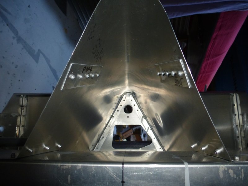

Kyle Communications Posted October 8, 2017 Share Posted October 8, 2017 Nice job...you know of course that is the main strength in the design.its actually supplied completed like that from ICP for the Savannah kits because it is the core of the main structure Link to comment Share on other sites More sharing options...
Marty_d Posted October 8, 2017 Author Share Posted October 8, 2017 Nice job...you know of course that is the main strength in the design.its actually supplied completed like that from ICP for the Savannah kits because it is the core of the main structure Thanks... no stress then!! Yeah Zenith supply them completed too, also the wing mainspars. Anything solid riveted I think. Link to comment Share on other sites More sharing options...

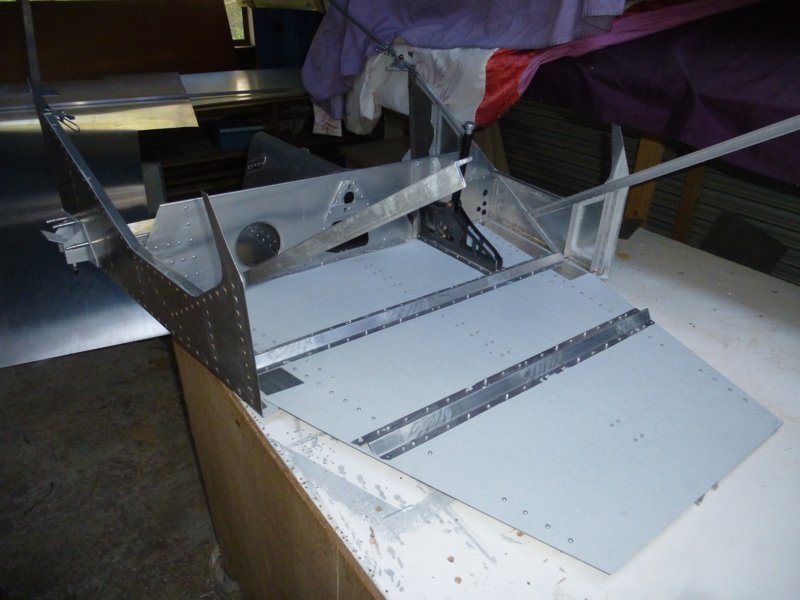

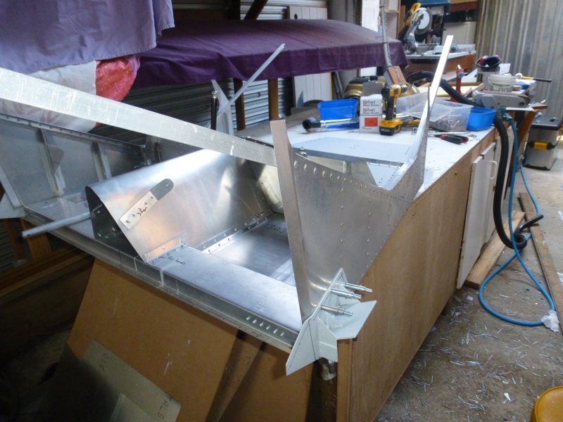

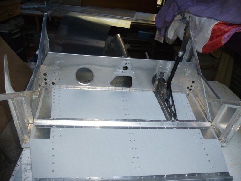

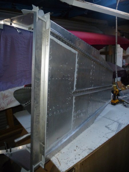

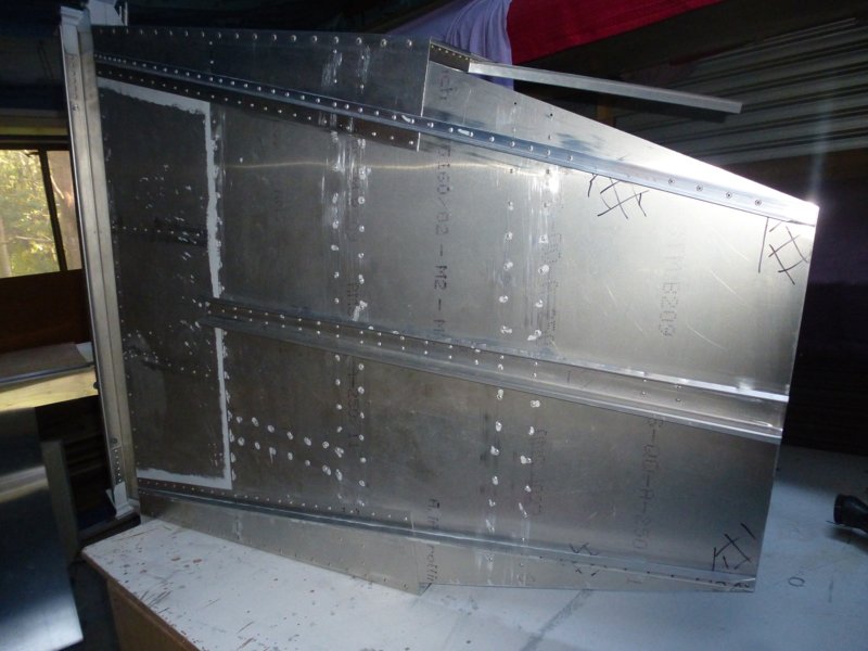

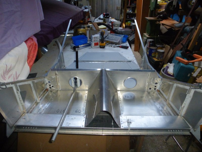

Marty_d Posted January 21, 2018 Author Share Posted January 21, 2018 Been a while but progress is slowly being made! The front fuselage is now complete (ignoring little things like firewall, seats, cabin frame, instrument panel etc...) Actually ran out of 1/8" rivets when nearly done, that's 5,500 of them used. Found a local supplier which was lucky. 5 2 Link to comment Share on other sites More sharing options...

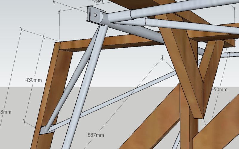

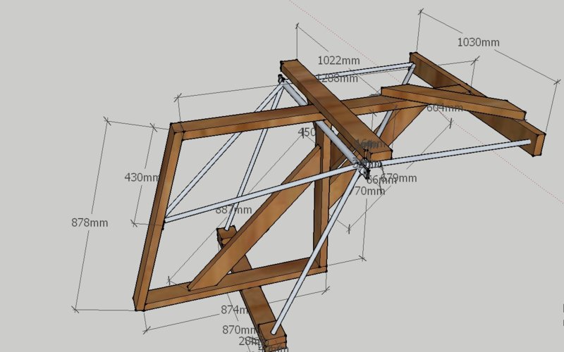

Marty_d Posted January 26, 2018 Author Share Posted January 26, 2018 Next bit requires me to get the cabin frame welded up. I've got all the chrome moly for it, so have made a 3D view of the frame plus a wooden jig (90x35 framing pine) to hold everything in place. If anyone else is scratch building, I can't upload the SKB file here, but PM me and I'll email it to you. Feel free to use it, but please double-check all dimensions first. SketchUp is available for personal use as a free download. 4 Link to comment Share on other sites More sharing options...
bexrbetter Posted January 26, 2018 Share Posted January 26, 2018 I can't upload the SKB file here, .skp file you mean. .skb is an automatic backup file that needs to be renamed to .skp 1 Link to comment Share on other sites More sharing options...

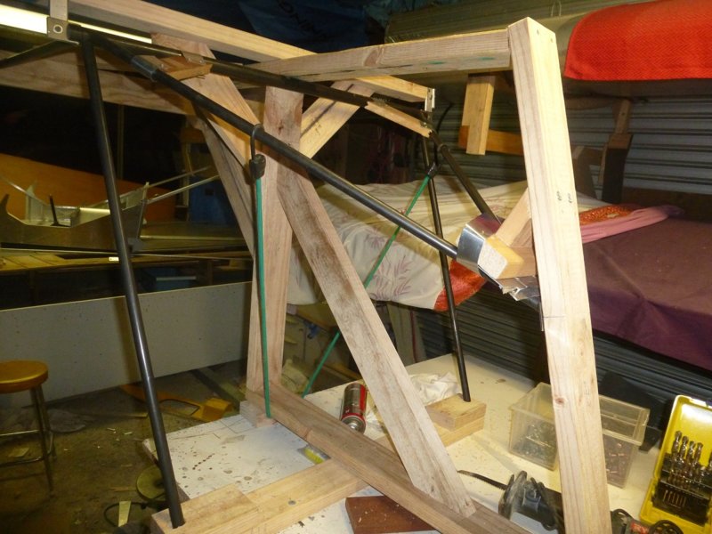

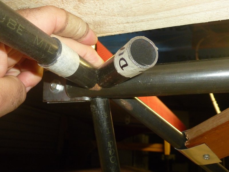

Marty_d Posted March 9, 2018 Author Share Posted March 9, 2018 Go the metal cut ready for welding - now I just have to find someone willing to weld it! Link to comment Share on other sites More sharing options...
Kyle Communications Posted March 9, 2018 Share Posted March 9, 2018 Hey marty those wing mount U sections you have made on the cabin frame. Are they made from Chrome Molly?...the Savannahs are made from stainless steel then welded to the chrome moly frame Link to comment Share on other sites More sharing options...
Head in the clouds Posted March 9, 2018 Share Posted March 9, 2018 Hey marty those wing mount U sections you have made on the cabin frame. Are they made from Chrome Molly?...the Savannahs are made from stainless steel then welded to the chrome moly frame Umm? As I understand it stainless must never be welded to CRMO because the joint will be very brittle. I'm no metallurgy expert but that's what research indicates ... Link to comment Share on other sites More sharing options...
Kyle Communications Posted March 9, 2018 Share Posted March 9, 2018 all of the Sav's those mounts we have tested must be stainless because a magnet will not stick to it al all..it does to the frame but not the U tags Link to comment Share on other sites More sharing options...
Marty_d Posted March 9, 2018 Author Share Posted March 9, 2018 Definitely not SS Mark... plans call for 0.080" 4130 plate for the U brackets and that's what they are. Yes they need to be welded too - hope there's enough top and bottom to weld to, they only protrude about 2mm. Link to comment Share on other sites More sharing options...
Kyle Communications Posted March 9, 2018 Share Posted March 9, 2018 Danny needs to make a new cabin frame for his S and mine has a lot of rust internally so we are making a jig to do just what you have done for both of ours Link to comment Share on other sites More sharing options...
Marty_d Posted March 9, 2018 Author Share Posted March 9, 2018 Yes a jig is the only way I could see to do it - position the frame in 3D CAD and draw in the wood to hold it in place. Link to comment Share on other sites More sharing options...
