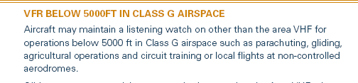

dutchroll Posted December 3, 2016 Share Posted December 3, 2016 7.3.1 When departing or arriving at non-controlled aerodromes, pilots should monitor their radios and broadcast their intentions in accordance with the following and paragraph 7.3.4: When at or near a non-controlled aerodrome or in a Broadcast Area with a CTAF, including those assigned Multicom 126.7, listen and broadcast as necessary on the published frequency. When at or in the vicinity of non-controlled aerodromes marked on charts that have not been assigned a discrete frequency, use Multicom 126.7. When operating at aerodromes not depicted on aeronautical charts, pilots should monitor and broadcast their intentions on the relevant Area VHF. If you're not "at or in the vicinity of" the aerodrome, you should be monitoring the applicable area frequency. In the vicinity: An aircraft is in the vicinity of a non-controlled aerodrome if it is within: airspace other than controlled airspace; and a horizontal distance of 10 NM from the aerodrome (reference point); and a height above the aerodrome (reference point) that could result in conflict with operations at the aerodrome. CAAP 166-1(3) Any local special procedures in ERSA of course override this. 1 1 Link to comment Share on other sites More sharing options...
Dinga Posted December 3, 2016 Author Share Posted December 3, 2016 Dutchroll, this is the only thing that casts a level of ambiguity on the rules as per your post. Seems that whilst the rule is quite clear perhaps this statement is why i find many people flying around on local 'joy' flights using only the CTAF Frequencies and not changing to an Area Freq when appropriate. Link to comment Share on other sites More sharing options...
coljones Posted December 3, 2016 Share Posted December 3, 2016 Dutchroll, this is the only thing that casts a level of ambiguity on the rules as per your post.Seems that whilst the rule is quite clear perhaps this statement is why i find many people flying around on local 'joy' flights using only the CTAF Frequencies and not changing to an Area Freq when appropriate. [ATTACH=full]47126[/ATTACH] Where is this from? AIP is prime, CAAP is advisory. Link to comment Share on other sites More sharing options...

dutchroll Posted December 3, 2016 Share Posted December 3, 2016 Where is this from? AIP is prime, CAAP is advisory. Sort of. CAAPs have no technical legal standing themselves which is why CASA puts the "advisory" legal disclaimer on them, but they are designed to summarise and explain the requirements of the legal documents such as CARs, CAOs, etc. they provide a list of the applicable references at the end which you can look up. Ignoring a current CAAP just because you can't find the corresponding reference is most unwise, in my opinion. You do it at your own risk. 2 Link to comment Share on other sites More sharing options...
coljones Posted December 3, 2016 Share Posted December 3, 2016 Sort of.CAAPs have no technical legal standing themselves which is why CASA puts the "advisory" legal disclaimer on them, but they are designed to summarise and explain the requirements of the legal documents such as CARs, CAOs, etc. they provide a list of the applicable references at the end which you can look up. Ignoring a current CAAP just because you can't find the corresponding reference is most unwise, in my opinion. You do it at your own risk. Yenn's was attributed to AIP, yours to CAAP - GOOD. Dinga's wasn't attributed to anything - NOT SO GOOD. Link to comment Share on other sites More sharing options...

Dinga Posted December 4, 2016 Author Share Posted December 4, 2016 Where is this from? AIP is prime, CAAP is advisory. Hi Coljones your back :-) it was actually from a VFR Flight Guide, although it looks like it may have been removed or relocated in the latest version of VFRG. but I am guessing that its roots are back in one of the other docs, I'll check. Ref Docs: VFRG 2014, VFRG March 2015. :-) Link to comment Share on other sites More sharing options...
