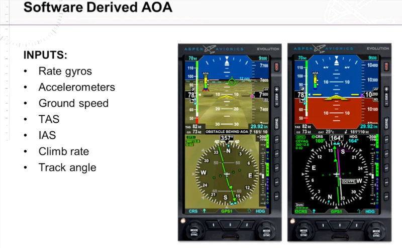

Garfly Posted January 31, 2017 Author Share Posted January 31, 2017 Yenn, I don't know where the Dynon gets its info from but the Aspen AoA indication is done entirely artificially - that is in software. It's nothing more than a software upgrade for their PFD; no sensors at all. The attached slide from an Aspen presentation explains the data inputs that they feed into their algorithm. Paul Bertorelli of AVweb did a review (and video) of the Aspen device here: What AoA Indicators Don't Do That They Should - AVweb Insider Article He's far from being a fan of safety-through-gadgetry but he goes on to say: "That's not to suggest that I think AoA indicators are a gimmick or not worth the investment. They're not especially expensive and they have the merit of reprogramming pilot understanding of stalls as an airspeed thing to an angle-of-attack thing, where it should have been all along. And that's why I think the marketing of these devices is off base. They're being sold as stall awareness devices when in fact, they're really performance-measuring instruments that happen to include stall warning and awareness capability. .... So we set up some slow flight and an approach flying on the AoA indications ... I found that moving the needles well up into the yellow band still gives—at least for me—comfortable stall margin but also four to five knots slower speed, making the touchdown less floaty and a lot shorter. Approaches flown too fast—very often way too fast because so many pilots are terrified of stalls—are a common scenario leading to excursions and overruns. And even if they don't, they use more runway than necessary and chew up tires and brakes. Further, the AoA flags are nicely damped and thus don't jump around nervously like an airspeed digital display or even an analog needle tends to do. It's thus a little easier to fly. It could also be used to index best angle or best rate for best performance departures. Ultimately, I'd like see AoA systems evolve in just the way I've described here—as speed indexers used on every approach to get the most out of aircraft performance and to wrap the sticker puller's head permanently around the concept of AoA. Otherwise, installing an AoA indicator is a little like having a live-in Cordon Bleu chef fix you spam sandwiches for lunch." Link to comment Share on other sites More sharing options...
