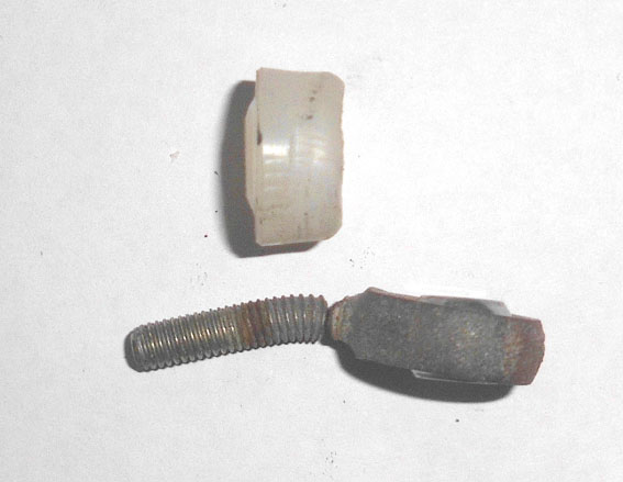

Oscar Posted April 23, 2017 Share Posted April 23, 2017 Bruce, I have no issue with your comment (basically) that 'over-maintenance' may introduce problems that did not exist. HOWEVER - lack of proper inspection and rectification of problems is more than equally dangerous. As you may be aware, I have been re-furbishing / re-building a post-crash similar Jab to yours, though mine is older ( airframe #50) and with more hours ( around 2700, mostly in flying school use). It was originally VH-reg ( the first VH-reg Jab. built, in fact) so it had been either LAME or L2 inspected every 100 hours. That's 27 inspections. In the last couple of weeks, I have been re-installing - with re-furbishing- (amongst other things) the flap actuation mechanism. I think your aircraft will have the same set-up: a manual flap handle with three detente positions: zero flap, take-off, and landing. There is a linkage rod between the flap handle and the flap actuation cross-tube - the one behind your head - horn. When we dismantled the crashed airframe (an EFATO), we noticed that the rod-end at the cross-tube horn had broken at the shank - which we put aside for later work- and assumed it was crash damage. Didn't take any attention to it. When I came to re-assemble, I looked at the mechanism - and it was immediately apparent that there were serious problems. The rod-ends at BOTH ends of the linkage rod between the flap handle and the flap actuating cross-tube were being badly fouled through lack of proper installation. There are witness marks on the linkage rod and wear on the cross-tube horn, plus breakage of the 'shroud' on the inner face of the flap handle. The thread on the male rod-end at the flap cross-tube horn was so badly bent that it was at best hanging on by a straw. This is not trivial: the first fatal in a Victa air-tourer was caused by exactly the same bending failure from an improperly-installed rod-end. Also, the 'button' on the backside of the flap handle that engages with the flap detente holes, was badly distorted, with very little engagement with the detente holes in the back-plate. Not quite as likely to be a critical failure if it disengaged - but if you are in a tight situation, you'd like your flap setting to be held properly - yes? Especially in an EFATO situation where you grab full-flap to get the bugger on the ground where best possible.. This is what had failed to be noticed by proper ( and professional) inspection and rectification: 1 1 Link to comment Share on other sites More sharing options...
