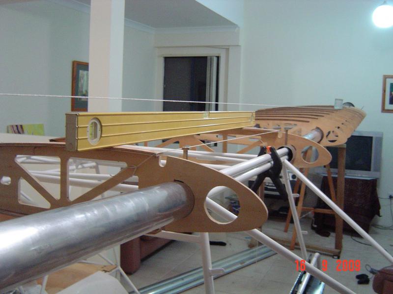

Brett Posted September 16, 2009 Share Posted September 16, 2009 [ATTACH]8672.vB[/ATTACH]guys I was just wondering what your thoughts are about the dihedral,,,, I have set my wings up on props and are just about to drill the wing mount holes ,,,so far I have set it up at 1 , 1.5 , 1.75 and 2 degrees ,,, 2 degrees looks like a heck of a lot however , ,, what would be the lowest setting would anyone know so the flap levers (placed underneath) will clear the fuse? to get the angle I have string lined the wings at 10 foot and taken measurements from another string line from the root ribs,,, any thoughts on this method or is there a better way? Btw yes the plane is in my house ,,,need to drill these holes so I can put it back in the shed but the shed ain't quite big enough too do this important bit and I could never leave my baby out in the cold with no shelter for all this time hehe. in this photo the wings are set at 1.5 Link to comment Share on other sites More sharing options...
Guest swede Posted September 17, 2009 Share Posted September 17, 2009 Hi Brett, Can't help you as my pup made "upside down" 2 deg with the flap levers on top.... Regards SWEDE Link to comment Share on other sites More sharing options...

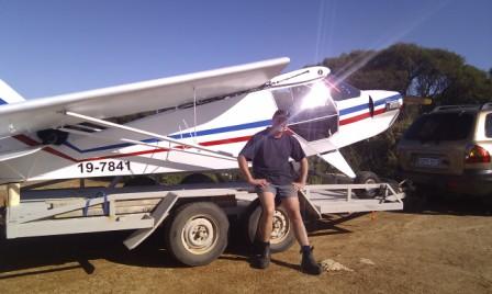

Brett Posted August 19, 2011 Share Posted August 19, 2011 After about 4 yrs at home I finally took my Aeropup to the airport,,, still have quite a bit of work to do on it before it's inspected and flown but getting closer all the time,,,, 1 Link to comment Share on other sites More sharing options...
kevinfrost Posted August 21, 2011 Share Posted August 21, 2011 Hi Brett, looks good.:thumb_up: Lots of fun ahead. What method of trim are you using on the Aero Pup? I found we had to use a fairly strong spring to take the elevator load to aid the trim tag. Cheers, Frosty. Link to comment Share on other sites More sharing options...
Brett Posted August 21, 2011 Share Posted August 21, 2011 I have just made the trim tab as per the instruction manual,,, exact sizes and all ,,, did you find it needed aid when set up for slow or fast flight? Link to comment Share on other sites More sharing options...
