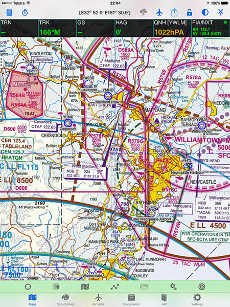

Speaking of Restricted Areas, I see that the 'temporary' Romeo zones to the west of Willy have finally made it onto the charts.
I think it's been a couple of years now that they've been in force but not indicated on any charts.
Whenever I've been listening to Area (125.7) the controllers seemed to be forever chasing errant aviators out of those spaces.
I'd made my own little waypoints on OzRWYs to remind me of the boundary corners.
I think they used to be called R976 and 977 in their temporary form.
But now they've taken the names of their close relatives:
R578F (4500/8500) and R578G (3500/8500)
So if you're buzzing around Cessnock/Maitland/Lake Macquarie or heading for the VFR lane (The curvy corridor top centre of screenshot) northbound, don't forget to duck your head in time. (Although you need to be at or below 1600' by the time you enter the lane anyway.)
By the way, that lane is only 3 miles wide for much of its length as it follows the railway. And because we're expected to keep right of the tracks, that gives 1.5NM useable width. So, no way to give a nice wide berth to the fast-jet playground surrounding the tunnel on three sides. (And the ground squeezes up to scarcely 500' in places, too, so no marginalia there either. ;-) It's a beautiful flight, though, on a nice day.
I think there are other tight squeezes around the traps, as well. For example, between Amberley and Brisbane airspace it gets down to just a 4NM eye to thread, at one point. At those tolerances, in a strange land, thank goodness for our (extra-legal) GPS/EFBs.
If you're unfamiliar, one hill and/or one shopping centre can looks sooo much like its nearby neighbour.

Speaking of Restricted Areas, I see that the 'temporary' Romeo zones to the west of Willy have finally made it onto the charts.I think it's been a couple of years now that they've been in force but not indicated on any charts.
That is what the AIP/SUP's are for Aeronautical Information Package (AIP) | Airservices (hope that link works, its from my account). I have always been taught to check them when flight planning.
True, the temporary restricted areas were there in SUP for all to see.
Still and all, the controllers, seemed to cut blunderers a bit of slack on the basis of it not being on the charts yet. They also tended to give out a lot of pre-emptive warnings on the same basis. It must have taken up a lot of their time and attention, actually.
So, all the area stakeholders must be pleased to see the new R zones finally get into print - of the map kind.
Those blunderers without transponders, though, might just remain fat, dumb and happy to this day. Romeo? Wherefore art thou?
Another blessing of the EFB age is that pilots - even the ill-trained and the errant - are more likely to be working with up to date charts. Plus, they're far more likely to have that AIP/SUP close at hand.
