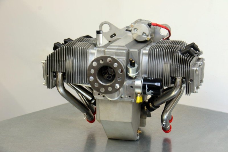

Doh its ok I was caught offguard with the impromtu tour..yes it is a split block with 2 blocks back to back now I think about it as it was a quick tour around. Sorry for the confusion. I was so impressed by what I saw....no I am not on those sort of drugs. I found some pics on a older thread..I am reposting them here incase others like me forgot

I am bemused at what appears, then, to be a fully externally-machined cast crankcase. An unnecessary expense, surely, for external, non dimensionally-critical or mating surfaces?. Most unusual.
I note that the sumps for both the engines on the Jab. web-site remain castings - as they have been since the first ones.
The castings look really neat..possibly cast in a small vacuum. There was machining on them but mainly flat areas machined and it looked very good but there was a lot of cast still visible and also just cast surface on the inside.. Maybe they hadnt finished them. There were about 10 on a pallet that had been machined and I saw one in the larger VMC. I wish I had pushed now to take some pics

Looks great. They should sell like the proverbial, particularly the six.
The six is particularly smooth. I flew the 230 to Bundi for a scheduled service. The new motors use practically no oil in 25 hrs. The new cast crankcase has the fuel pump set back closer to the flywheel so that it can be removed without first removing number 5 cyl. Cooling fins on the new cylinders are much larger.

Unfortunately the inlet tract and carb appears to remains the same, so the mixture distribution may be still compromised , otherwise it seems to be a great leap forward. Lets also hope that the oil resevoir is a little bigger, oh yeah and the rocker bushes have a greater oil flow to them. And that the generator is not the same "on the end of the crank" affair. Oh dear! what am I saying? Ally barrels do not a new engine make.....

Probably sells 20% of their engines, although I don't think this one looks as good as the last.

Havent seem a pic yet of 3300 with cast case yet
2200 have cast cases, 3300 do not.
Last time I was there, the large stack of broken 3300 were kept to be upgraded to new models - not a bad thing as the old cases rarely had problems other than crook assembly
