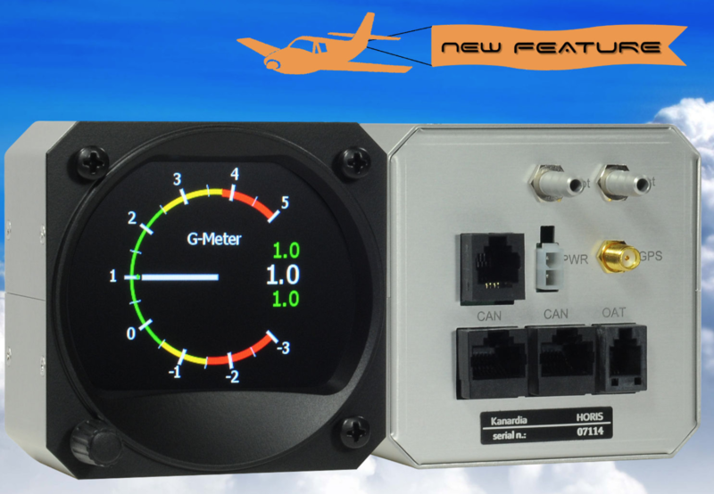

Regarding G-Meters, I see that Kanardia have just added that functionality to their round Horis instrument.
(As a full screen display switchable from the PFD / DI screen options.)
In light of what's been said above I'm hoping I can get the feature working on my own unit with a firmware upgrade.
Horis - Kanardia
News - Kanardia
It doesn't go far enough positive or negative.
A G meter that keeps a permanent record of max readings might be appreciated by pilots renting aircraft.
Even more so for owners renting their airplanes, as I do.
About the Kanardia scale, I'm wondering if the range is adjustable in software.
I'd assume the coloured zones are a user setting (as they are for the Airspeed tape).
And/or maybe the max. value digits do record over scale values.
Something to research.
