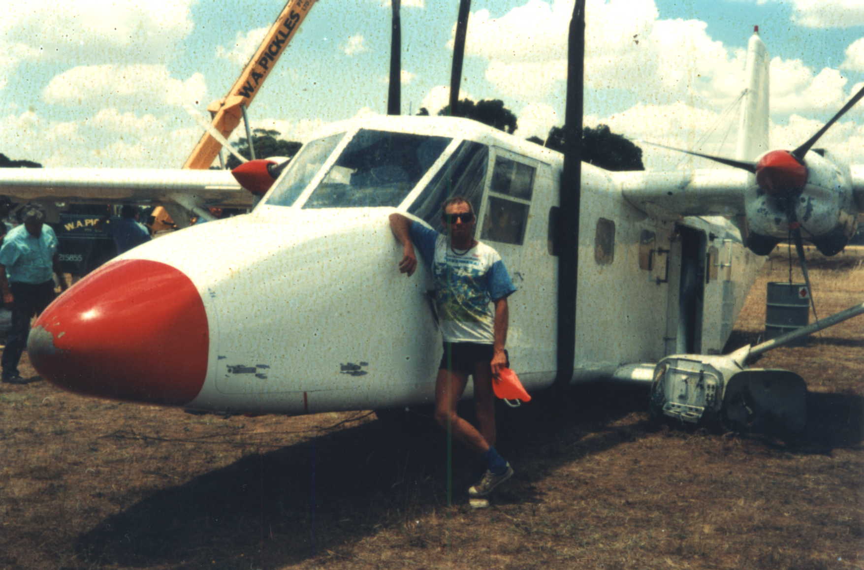

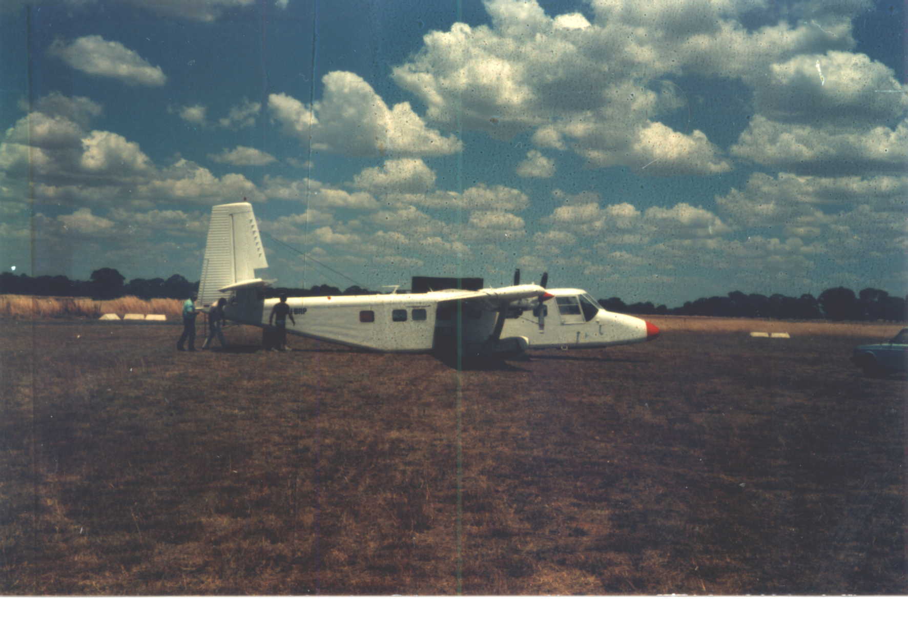

Procedure for gear retract.
Ozzie, that is the correct procedure for multi engine, where the engine-out climb becomes the critical factor. It could be noted that gear extended ferry can be available ( at a reduced weight , to allow the climb to be achieved ). Nev...
i didn't do this, I just pick em up. the ferry to workshop was with gear locked down and reduced speed applied. the tailplane also had to be replaced lots of poped rivets and canning on it. good thing it rolls on its wheels when the door skins crush up.
result from a attempted go around in a storm. must have positive rate of climb before selecting gear up. there was about 1000mts rw left
personally i'd wait a bit as when the mains doors open they are a few square feet of drag.
anyone out there ever work on these?

When I was stripping a Nomad, I wondered why it had retractable mains, it seemed to me that a fixed and faired gear wouldnt take much away speed wise - considering the aerodynamic mess of the gear pod, struts etc.
HPD
absolutely weirdest set of retract gear i've seen. narrow, oleos, small wheels, small brakes and heavy.
chain drives the nose gear. if you fill the tip tanks the oleo will drop and suddenly the wing tip is 3 feet lower or jammed on the ladder. come to think of it the only good thing about this aircraft was that it filled your schedule of experience log real fast.
