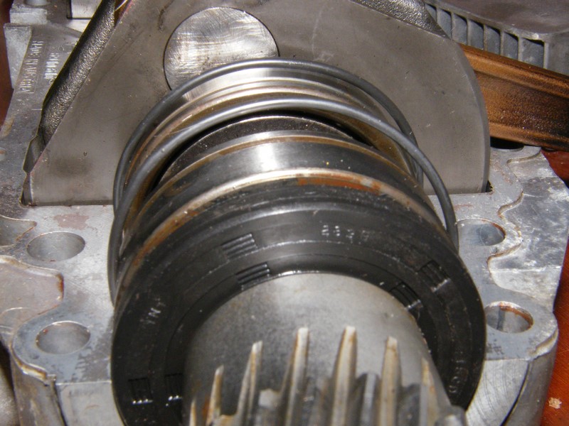

Deskpilot Posted October 24, 2017 Share Posted October 24, 2017 Calling all Rotax 503 experts. I'm in the process off rebuilding my engine and, being a very early(si/sc), it has main bearing plugs in the upper crank-case half. These have a step on them as to indicate a fitment orientation. Anyone know how they should be aligned? Also, when sitting the crankshaft in place, the O-rings (64 x 2) get pushed up so as to be too big Any advice? When I stripped the engine, only debris from earlier rings was present. P.S., engine has still to be finally cleaned so I know it not ready for bolt down. Link to post Share on other sites

corvairkr Posted October 25, 2017 Share Posted October 25, 2017 Deskpilot, Is this any help to you ? Rotax, Rotax 503 aircraft engine repair manual. Jason Link to post Share on other sites
Deskpilot Posted October 25, 2017 Author Share Posted October 25, 2017 Many thanks Jason. It seems that my engine is a mixture of old and new. i.e., provision for rubber plugs(early models) and o-rings(later models). The step in the plugs must be due to wear as there's no mention of orientation in the manual. With regard the o-ring fitment, seems I've got the wrong size in a couple of places. I thought they were all the same size. I've been advised that "most people" leave them out and seeing as I have the plugs, albeit a bit worn, I'll rely on them. It would appear that they're there only to prevent the bearings from rotating in the housing rather than providing compression sealing between cylinders or the outside world. 1 Link to post Share on other sites

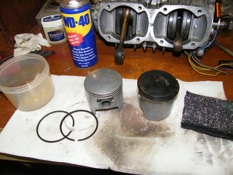

Deskpilot Posted December 18, 2017 Author Share Posted December 18, 2017 Sing along now..."What a difference a day makes......." de-coking my pistons. 24 hours soaking in WD-40 and a light scrub with a pot scourer. I said LIGHT......OK! According to advice found on the net, there should be markings on the top to indicate which side faces the exhaust port. I can see some id marks but nothing else. How do I determine the correct way to refit them? Link to post Share on other sites
facthunter Posted December 18, 2017 Share Posted December 18, 2017 By where the ring gaps are. Don't have them so as to go near the exhaust port. Nev Link to post Share on other sites

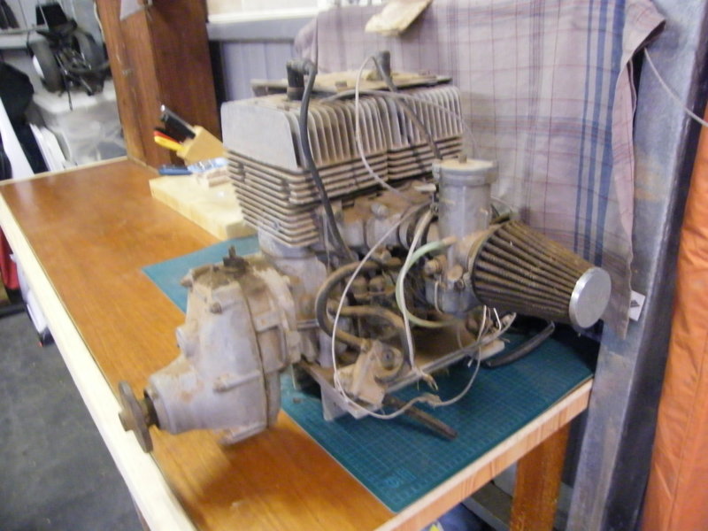

Deskpilot Posted March 21, 2018 Author Share Posted March 21, 2018 Thanks guys. My next problem soon raised it's ugly head, refitting the gearbox with the few studs I have left over. Don't think I've lost any of them but there's more holes than studs. I looked up views of an exploded engine and got totally confused as to what type of gearbox I have. I initially thought it was a type B but then changed my mind to a type A with an adapter plate. ????????? Engine as found. I'll play with it again today after I remove the recoil starter assembly. I found the magneto securing nut and washer still on my bench last evening. Ya know, I always thought I was a careful planner and orderly in stripping engines (I've done quite a few early types when home maintenance was possible) but this is my first 2 stroke. Simple....yes, but I'm confused by that simplicity. Link to post Share on other sites

Deskpilot Posted March 22, 2018 Author Share Posted March 22, 2018 Haha, too true Butch. I was hoping somone would confirm what type of gearbox I have. Please Link to post Share on other sites
Methusala Posted March 22, 2018 Share Posted March 22, 2018 The "A" type and the "B"type boxes are, as far as I know, identical in size. The difference is mainly in the no. of Bellville washers exerting pressure on the clutch. I had the modification done by Floods years ago. Link to post Share on other sites
Deskpilot Posted March 24, 2018 Author Share Posted March 24, 2018 Meth my man, not so sure about your statement. Mainly as there's no clutch involved. Link to post Share on other sites
Methusala Posted March 25, 2018 Share Posted March 25, 2018 When I say "clutch" I am referring to the coupling which consists of 2 mating inclines which is spring loaded by the bellville washers. This is designed as a simple slipping coupling to minimise transmission of power pulses to the propeller which would act as an inertial flywheel. Called a dog clutch I think. (Ahem...) If you can get my drift. Also, the "A" type box had a rough, sand cast finish: the "B" box was smooth. Just found this link to Youtube also. Link to post Share on other sites
