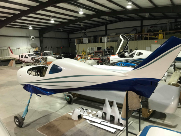

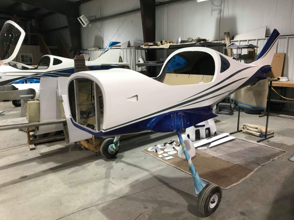

flyvulcan Posted November 10, 2018 Share Posted November 10, 2018 Our Lightning just got back from the paint shop. It will be reassembled, the control runs will be installed and the interior will go in. It’ll the be taken apart again and shipped to Adelaide to await the installation of the instrument panel and firewall forward. 3 1 Link to comment Share on other sites More sharing options...

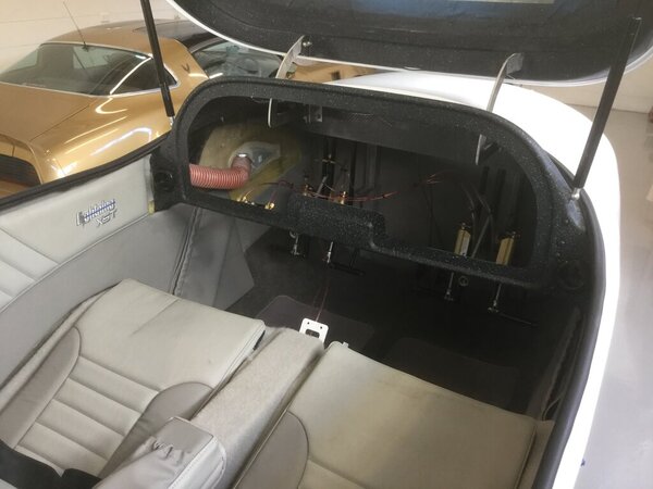

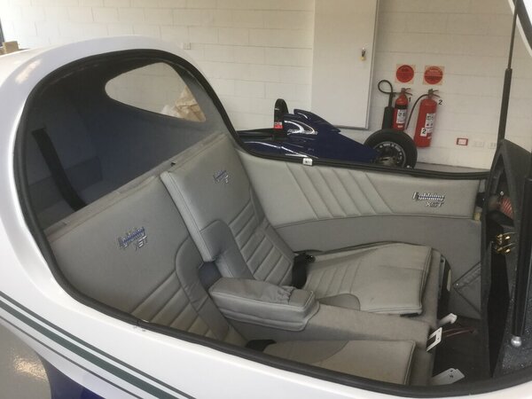

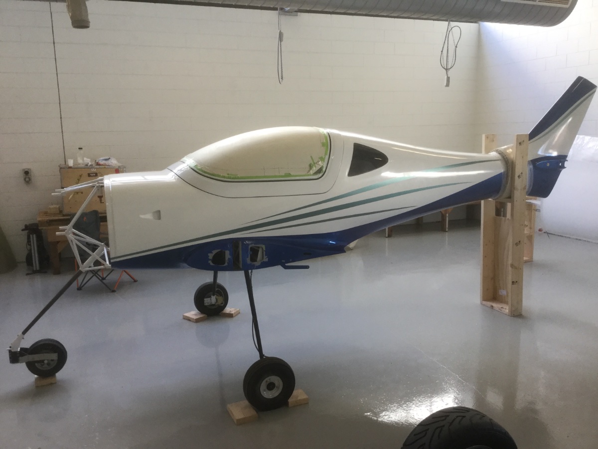

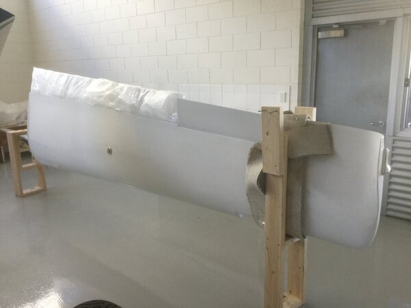

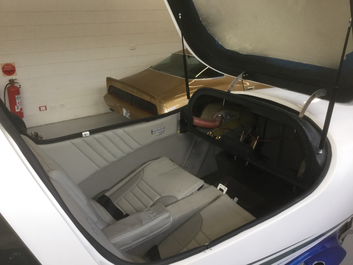

flyvulcan Posted September 16, 2019 Share Posted September 16, 2019 As luck would have it, our Lightning was delivered to our workshop in Adelaide a few weeks ago. It has been unpacked and we shall shortly begin to assemble all the components that were removed for painting and were shipped loose, i.e. gear leg fairings, wheel spats etc. Once assembled, we will generate the to-do list. Obvious tasks left for us are to design and install the panel and complete the firewall forward development and finishing the installation of the engine, system and cowling. Here are some photos of it in our workshop so you can see how it has turned out so far: Cheers, Dave 3 Link to comment Share on other sites More sharing options...

langted Posted June 5, 2021 Share Posted June 5, 2021 Dave: I Love your interior! I'm not surprised that the engine isn't ready yet. It always takes 3 times longer than your worst nightmare (especially near the tail end of a project) and that's not even counting COVID! But what a sweet demo plane it'll be when its ready! Mine is waiting for the guy to put the upholstery in. When will happen, I'm not sure even the Great Almighty knows! But at least it can fly without it. Wiring is about 95% and my panels are in place and have been fired up. I have two Dynon 10" screens and a Garmin 650 -- that uses up about all the available real estate. If I had it to do over, from a panel perspective, I think I would have gone with a 10" and a 7" screen to give a few more options for other stuff. I am planning on Driving back to Shelbyville on June 15, and hoping for an airworthiness inspection on June 16 or 17. Ill report back once its flying. Ted Link to comment Share on other sites More sharing options...
TurbAero Posted June 6, 2021 Share Posted June 6, 2021 (edited) Hi Ted, We had our interior done by Nick’s interior guy. It took a loooong time to get done and required a fair bit of pestering to get done. But once in the aircraft, we were very happy with the results. We have been thinking of a 10” and 7” for our panel. We would like all the bells and whistles so autopilot etc. We have not yet settled on Garmin or Dynon but are leaning towards the G3X suite. If you get any video from the first flight, please post it on Nick’s Facebook page if you are on Facebook. If you can put it here as well, I’m sure there will be many viewers here that would like to see it. I wish you all the best for next week and for a smooth first flight. Dave Edited June 6, 2021 by TurbAero Link to comment Share on other sites More sharing options...
