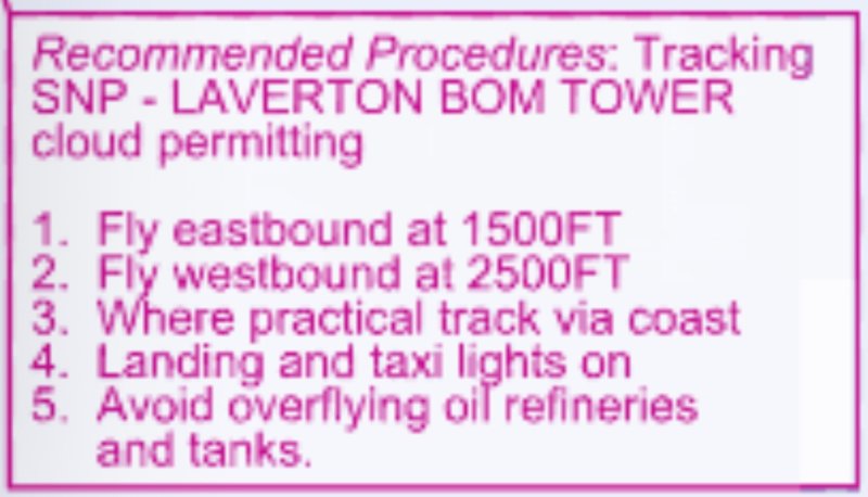

To cross over with another thread, that box with the recommended procedures only shows up in OzRunways if you zoom in so far that you can't actually see any useful features on the map. People who don't use paper maps may not be aware of it.

FYI, I have both AvPlan and OzRunways. Whilst the OzRunways “Hybrid VFR” map seems to require a bit more zoom/expansion for that inset-note to appear, pre-selecting the “Moorabbin Inset” map whilst flying in that vicinity provides all the zoom-out & pan flexibility you are likely to want in that area. That way the note remains always visible with that inset map.

It's not just whether you can see the note, it's whether someone who doesn't know it's there will find it in their normal use of the map - preferably at the flight planning stage.
There are other notes on that map too - what about the note about the aerobatic area, or the notes about flying east of the CTR and the north eastern VFR route?
It's not just whether you can see the note, it's whether someone who doesn't know it's there will find it in their normal use of the map - preferably at the flight planning stage.There are other notes on that map too - what about the note about the aerobatic area, or the notes about flying east of the CTR and the north eastern VFR route?

There are also text notes similar to the one for the coastal route- not just lines on the map. How many ipad users know the notes exist?
