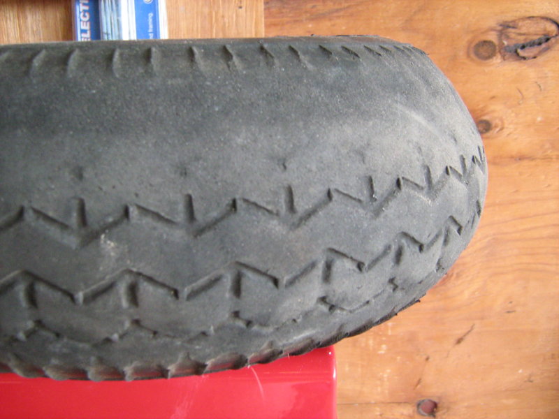

Bruce Tuncks Posted November 29, 2017 Author Share Posted November 29, 2017 Thanks for the comments guys. I will ask the factory but don't expect too much from them. Here's a pic I took today of the tyre which is about to go in the bin. But see how the outside has worn away badly. The worst wear is where you wouldn't even think the tyre was touching the runway, well this must be wrong and I must be doing something wrong to get this result. Link to comment Share on other sites More sharing options...
Camel Posted November 29, 2017 Share Posted November 29, 2017 I used a lower pressure than recommend on the main for a smoother ride on a grass strip but when on bitumen got excessive wear on one side, now on recommend pressure and much better wear on mains but ride is not as nice ! Just my observation. Link to comment Share on other sites More sharing options...

kasper Posted November 29, 2017 Share Posted November 29, 2017 Thanks for the comments guys. I will ask the factory but don't expect too much from them.Here's a pic I took today of the tyre which is about to go in the bin. But see how the outside has worn away badly. The worst wear is where you wouldn't even think the tyre was touching the runway, well this must be wrong and I must be doing something wrong to get this result. Seems from the pic to be combination of under inflation and alignment as you’ve excessive wear on both edges compared to tire centre. I’d try just inflating more on one set of tires and see if it is ok - you’d be amazed how much excess scrubbing can be added from just excess softness on a tire. 1 Link to comment Share on other sites More sharing options...

Bruce Tuncks Posted November 29, 2017 Author Share Posted November 29, 2017 Thanks kasper, thats an easy thing to try... I'll go to 40 psi and see if that helps... the glider has 45 psi on its one wheel with no springy legs so 40 should be safe on the Jabiru. Link to comment Share on other sites More sharing options...

Camel Posted November 29, 2017 Share Posted November 29, 2017 Thanks kasper, thats an easy thing to try... I'll go to 40 psi and see if that helps... the glider has 45 psi on its one wheel with no springy legs so 40 should be safe on the Jabiru. It will make a huge difference as I mentioned earlier ! The wear on the outside is in my opinion due to the low pressure, you will find it very different on the takeoff roll on rough ground, Link to comment Share on other sites More sharing options...
Roscoe Posted November 29, 2017 Share Posted November 29, 2017 Recommended pressures on my 170 is 45 for mains and 30 for nose. I seem to get more wear on the LH Main in the middle for some reason? Link to comment Share on other sites More sharing options...
Bruce Tuncks Posted November 30, 2017 Author Share Posted November 30, 2017 The tyres I am using have a stamp " max pressure 250 kPa" which is 36psi. The previous pressure used was 25psi which Jabiru specified. Increasing the pressures makes sense when you consider how the crown of the tyre is relatively unworn, so I have pumped them up to 35psi but haven't had a test flight yet on account of a thunderstorm today. After the advice here, I am coming to the conclusion that it was a combination of too little pressure and too much toe-in. Link to comment Share on other sites More sharing options...
