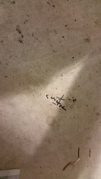

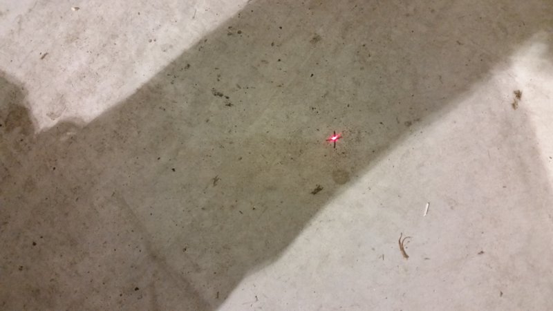

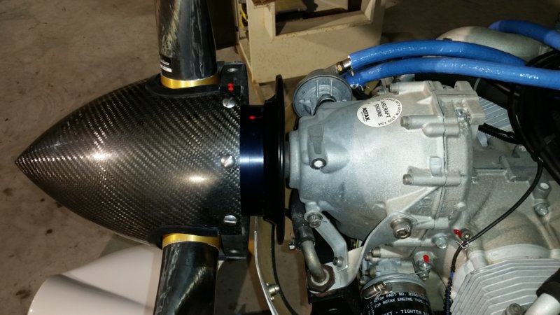

Blueadventures Posted June 26, 2018 Share Posted June 26, 2018 Fitted the propeller balance master this afternoon. Should get a fly in this weekend. Also checked the propeller blade pitch relationship with a laser pointer fitted to the angle tool. All within 3mm at 1300mm arm length. (If anyone knows the math formula to work out the degree of pitch difference I would appreciate it. I'll need to refresh on this math but not tonight.) Looking forward to the next flight. Link to comment Share on other sites More sharing options...

Kiwi Posted June 26, 2018 Share Posted June 26, 2018 Instead of having the laser aimed at the floor, set it up so it is aimed at the leading edge of the wing. That way it won't matter if the plane moves slightly when you turn the prop. Link to comment Share on other sites More sharing options...
Kyle Communications Posted June 26, 2018 Author Share Posted June 26, 2018 Mike you need to turn the balancemaster 180 deg so that the ring is towards the prop...your losing mechanical advantage with the way it is...unless of course it doesnt fit but it looks like it will. The further forward you can get that ring of mercury the better 1 Link to comment Share on other sites More sharing options...
skippydiesel Posted June 26, 2018 Share Posted June 26, 2018 Mike you need to turn the balancemaster 180 deg so that the ring is towards the prop...your losing mechanical advantage with the way it is...unless of course it doesnt fit but it looks like it will. The further forward you can get that ring of mercury the better Hi Kyle - Interesting comment. I believe Balance Master supply a "ring" that is designed to go in front of the prop - are you suggesting this would be the better location ? This web site BALANCE MASTERS PROPELLER UL912 - Aeroplans Blaus supplied by Blue Adventure, shows the ring facing back (gear box direction) - your comment? Link to comment Share on other sites More sharing options...
Kyle Communications Posted June 26, 2018 Author Share Posted June 26, 2018 The rotax gearbox has a ring flange on it that the 912 balancemaster fits over so its made to fit there but the savannahs have a prop extension of about 5 inches and that ring ridge is on the prop extension so you can stick the balance master further out. It would be even better on the front of the prop as it will have better ability to balance even more out of balance further out of course due to mechanical advantage. On my bolly hub you need to make a spigot to go into the bolly hub to be able to centre the balancemaster on the front of the bolly hub. I have made the spigots but because of the slots in the balance master you need to fit washers onto the front to make sure the prop hub nuts bite better onto the front of the balance master. I didnt have any washers at the time so I put mine on the front of the prop extension which puts it on the back of the bolly hub 1 Link to comment Share on other sites More sharing options...
Blueadventures Posted June 27, 2018 Share Posted June 27, 2018 Hi Kyle - Interesting comment. I believe Balance Master supply a "ring" that is designed to go in front of the prop - are you suggesting this would be the better location ? This web site BALANCE MASTERS PROPELLER UL912 - Aeroplans Blaus supplied by Blue Adventure, shows the ring facing back (gear box direction) - your comment? Hi Skippy Alf Jessup is running a balance master and is happy with its performance. Fitted same orintatiion as my images. Mark has it working in his fitup at the prop end of the spacer. I had read about the requirement to fit it to flange rather than between the spacer and propeller (I believe that may be due to out of square machining of the spacer mating surfaces, etc). I'll try it as its presently fitted and work from there. I don't have the long spacer that Savannahs require so I believe it should be satisfactory at the 912 ouput flange. You could pm Alf and get more detail about his setup as it may be a similar fit up to your aircraft. Daniel also imports undrilled balance masters so I would expect that he and Mark may CAD a template and drill specifically for the Savannah's long spacers and maybe re work the spacer with a spigot to allow perfectly centered fitups. I'll provide feedback to the forum after putting on a copuple of hours. Cheers Mike Link to comment Share on other sites More sharing options...
Kyle Communications Posted June 27, 2018 Author Share Posted June 27, 2018 I noticed the difference even on the ground Mike...I started it up after fitting it and I could tell straight away it was substantially better Link to comment Share on other sites More sharing options...

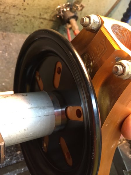

skippydiesel Posted June 27, 2018 Share Posted June 27, 2018 Mike & Kyle: My prop/cowling/extension set up is tight, so to have the best chance of ordering the BM that will fit, I need to have accurate hopefully consistent information I seem to getting more & more confused with what should be a simple matter:- Daniel's BM 912 dimensions are OD 183 mm, ID 47 mm, 18 mm offset, flange 127 mm, slotted holes (this looks like the one you guys have fitted) Daniel also has a Flat, OD 175, ID 25.4 mm, 8 mm holes which may be suitable Mikes "Aeroplans Blaus" web site drawing has the 912/914 as an OD of 169 mm & 18 mm offset, slotted holes (which is correct ???). The Aeroplans Blaus photos of installation, show the offset back, towards the gearbox - This may be for cowling clearance reasons Link to comment Share on other sites More sharing options...
Kyle Communications Posted June 27, 2018 Author Share Posted June 27, 2018 Having the ring more forward is better. The rotax one with the slots Daniel and I have measured to the outside..maybe the french site measured to the inside of the balance tube..that 169 would probably be to where the tube joins the main flat plate. If you go on daniels dimensions as they are the ones actually in his hands and he has measured. Link to comment Share on other sites More sharing options...
Kyle Communications Posted June 27, 2018 Author Share Posted June 27, 2018 Skippy what engine do you have?...if its a Rotax 912/914 just get the slotted on as std...it will fit either facing forward or backwards or on the front of the prop hub inside the spinner Link to comment Share on other sites More sharing options...
