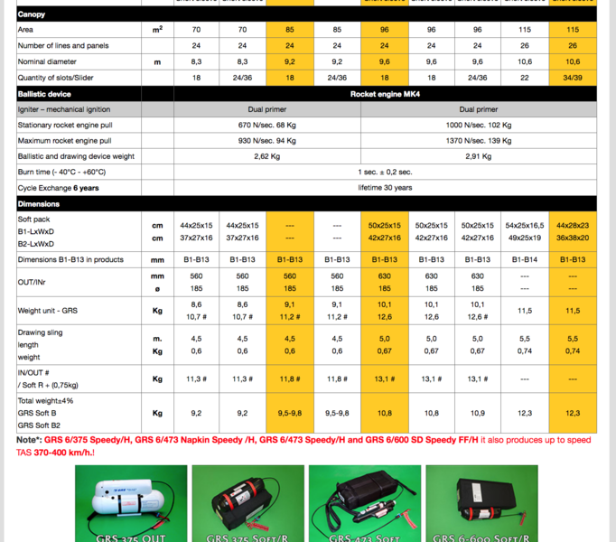

Kyle Communications Posted March 16, 2018 Share Posted March 16, 2018 well most of the cases a BRS was used it saved lives...there are always exceptions but are in a small minority. I think I would much rather have the option than not Most BRS weigh around 13kg or so Link to comment Share on other sites More sharing options...

Old Koreelah Posted March 16, 2018 Share Posted March 16, 2018 well most of the cases a BRS was used it saved lives...there are always exceptions but are in a small minority. I think I would much rather have the option than notMost BRS weigh around 13kg or so I saved about half a kg by removing the metal case and mounting the components onto the aircraft structure. Link to comment Share on other sites More sharing options...

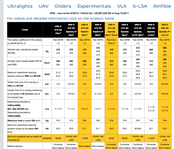

jetjr Posted March 16, 2018 Share Posted March 16, 2018 What speed does a brs enabled aircraft hit the geound? How does that compare to a RAA 45kts stall speed arrival? Link to comment Share on other sites More sharing options...
Kyle Communications Posted March 16, 2018 Share Posted March 16, 2018 6 to 7 m/s decent rate they quote thats at 600kg Link to comment Share on other sites More sharing options...
Garfly Posted March 16, 2018 Share Posted March 16, 2018 I guess it depends on a lot of factors including size of 'chute, AUW, Density Altitude and also, I'd say on whether there's a pendulum effect in play. Maybe all you can say is that very few of the hundreds of BRS saves have not been survivable as far as the arrival goes. Typically, though, enough damage is done to the airframes in the process that they're written off. I think it's expected that the undercarriage - assuming it's pointing in the right direction - will do a lot to soak up the shock. (My undercarriage would be well used to it ;-) It'd be good to have collapsing seats like choppers commonly have to absorb some of the vertical shock to the spine in hard arrivals. But front-on impact at maybe four or five times the velocity is surely going to hurt more. But then, no two accident sequences are ever alike. (Except when crash dummies are driving.) In any case, the aim of the game in a forced landing is to not hit anything. Whereas, under umbrella power, you know for sure that Mother Earth is going to whack you hard when you get home. Link to comment Share on other sites More sharing options...
Old Koreelah Posted March 16, 2018 Share Posted March 16, 2018 6 to 7 m/s decent rate they quote thats at 600kg That's hitting the ground vertically at over 20km/hour, as against arriving at a shallow angle at about 80km/h.No wonder BRS are particular about how their product is installed; they insist the aircraft depends at a nose-down attitude so that the undercarriage absorbs most of the impact. Link to comment Share on other sites More sharing options...
Kyle Communications Posted March 16, 2018 Share Posted March 16, 2018 Mine is a Galaxysky parachute Mine is the column second last on the right hand side...the GRS 6 600SD speedy 115 sqM Link to comment Share on other sites More sharing options...
