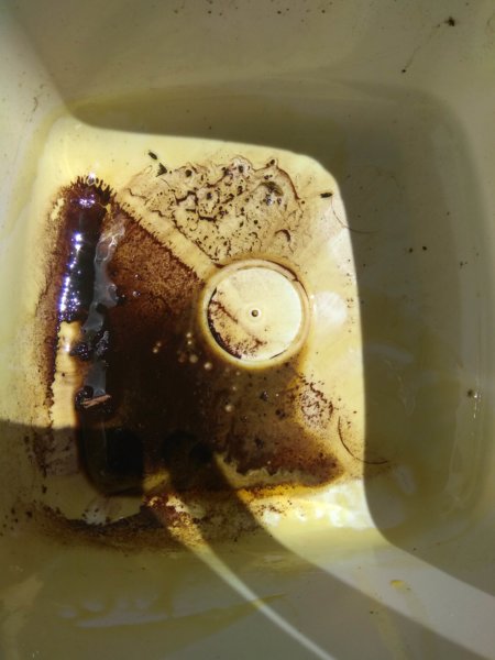

fly_tornado Posted March 19, 2018 Share Posted March 19, 2018 This is what 20 years of premix from steel fuel cans leaves behind Link to comment Share on other sites More sharing options...
