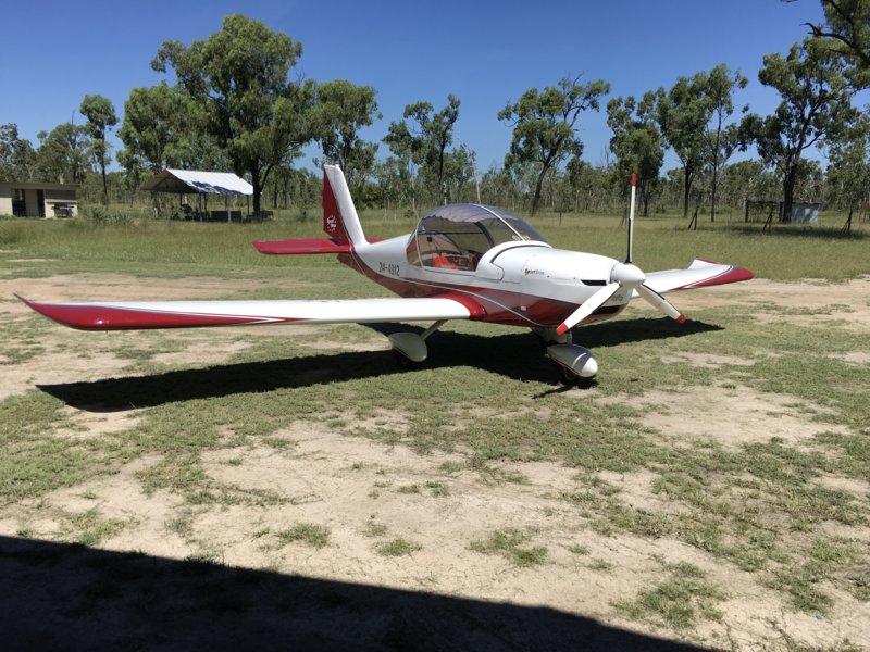

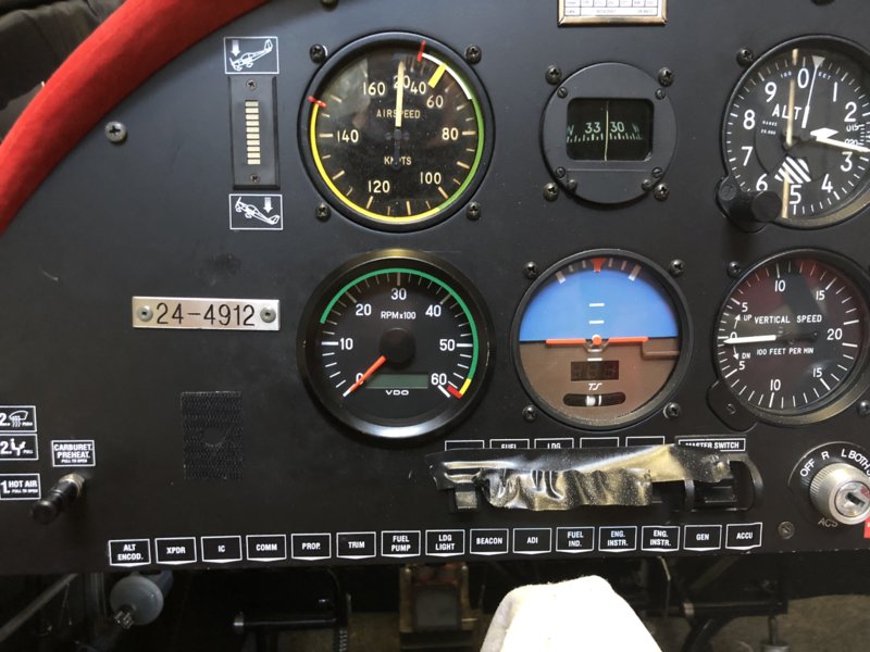

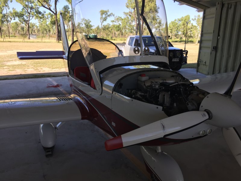

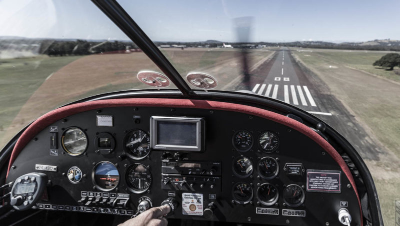

BirdDog Posted March 23, 2018 Share Posted March 23, 2018 Yeah - I guess they the same thing! :) We organised a full report be done. I was very lucky. My bird is an 06 model that had just over 160 hours and presented as almost new. :) Some pics? Sure. Attached are the pics of 4912. She is an Evektor Sportstar Max, with the Rotax 912 ULS and In Flight Adjustable Prop. These are some of the pics from when we picked her up and on the way home, and then one on final at YWOL. Enjoy! Link to comment Share on other sites More sharing options...
BirdDog Posted March 23, 2018 Share Posted March 23, 2018 PS - I have since added a new big fat Tacho right in front of me with approval from RAA and Evektor Link to comment Share on other sites More sharing options...

kgwilson Posted March 23, 2018 Share Posted March 23, 2018 PS - I have since added a new big fat Tacho right in front of me with approval from RAA and Evektor That's where it should be. Why so many (European) manufacturers have a tiny tachometer clustered with the engine instruments on the right has always intrigued me. They are hard to read and get accurate engine rpm & if you are not familiar with the A/C take a bit longer to locate amongst all the other same size round instruments. Link to comment Share on other sites More sharing options...
