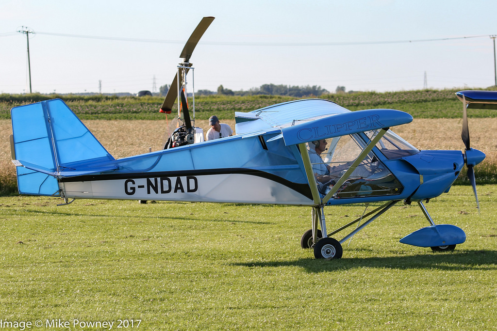

I know its an old thread and post but the Cheetah was also developed further and certified to BCARS int eh UK as the Medway SLA series and they are MUCH lighter than you might think ...
80hp 912 - empty 269kg
100hp 912 - empty 270kg
shorter wing 100hp 912 - empty 269kg
All needed a lot of weight trimming - not cheap to achieve - lighter weight composites, lithium batteries, full elelctronic dash.
So it IS possible to get an decent 912 powered airframe under 300kg with all the bells and whistles ... AND all tested and certified to 472.5kg so they have 200kg useful load - not fantastic but UK microlights are limited to 472.5kg so thats life
