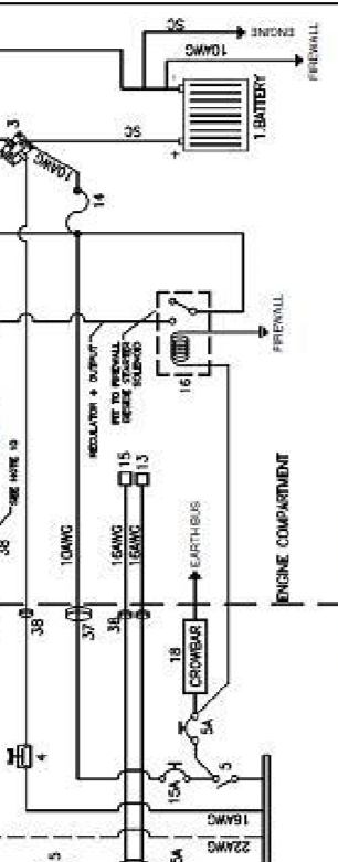

Jabiru7252 Posted May 6, 2018 Author Share Posted May 6, 2018 The charger has been tested as working okay since the fire. We will never really know the cause. By the way, if you look at the wiring diagram for the Jab, JTM001-8, page 268 of 301 you will see an error. A relay is permanently wired across the battery!!! Jabiru have confirmed this is a mistake and the connection should be on the bus side of the switch. Link to comment Share on other sites More sharing options...
