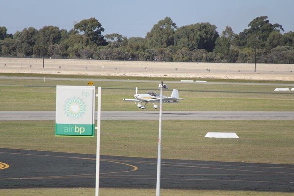

The initial flight was organised through a very helpful Jandakot Tower at 0900 - light traffic only. So light in fact, that I was cleared for takeoff before the camera crew had settled on the 'tower' hill. The circuit used was LH off 06 Left, and then a rectangular LH, wide, 'circuit' was flown at 75-80% power settings for 20 mins. Everything behaved itself. It flew wings level, hardly any rudder needed even at this cruise setting.  The acceleration was rapid, (see the vid), and it was through 110 KIAS in a matter of seconds, with a 1000+ fpm ROC.  Nearly busted my clearance of 1000ft!  Seemed more sensitive in pitch than other RVs, but generally, it flew very balanced and responsive. 65 over the fence with full flap and a trickle of power allowed it to handle the small crosswind and touchdown neatly on the mains.  Will post more when we get seriously into the test flying.
