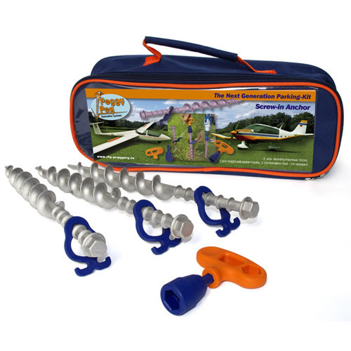

Downunder Posted August 5, 2018 Share Posted August 5, 2018 Don't buy one of these. I broke the head off one peg ( brittle aluminium) and the plastic spanner slips on the head if ground is hard.... Link to comment Share on other sites More sharing options...
pmccarthy Posted August 5, 2018 Share Posted August 5, 2018 Screw in pegs don’t seem to work in Australian soil. I have yet to find a spot where they do. 1 1 Link to comment Share on other sites More sharing options...
skippydiesel Posted August 6, 2018 Share Posted August 6, 2018 Screw in pegs don’t seem to work in Australian soil. I have yet to find a spot where they do. Cant say I agree (although I have never experienced very high winds while away from home) - 'Don't know what mine are called (came with aircraft in yellow plastic satchel) there are 4 screw in pegs, about 300 mm long, that require a thick dowel (or similar) to be inserted in the looped above ground end (making it like a wine cork remover/same action). I screw them in , at an angle in the ground, at the four cardinal points and then, using wing tip, tail built in tie down points and the forth round the prop flange, tie down to the exposed loops . I make my tie downs straps firm (no slack for wind gusts to "work" the pegs) Its rarely easy to get them in/out but then this gives me reassurance that they will withstand considerable lifting force. I don have "gust locks" so strap the joy stick and hope the nose wheel on round will inhibit rudder movement. Link to comment Share on other sites More sharing options...
pmccarthy Posted August 6, 2018 Share Posted August 6, 2018 These are the ones that don't work for me. Link to comment Share on other sites More sharing options...
