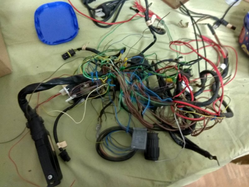

fly_tornado Posted February 21, 2018 Share Posted February 21, 2018 but that would be the same with any engine, look how much time your average jab home builder spends tweaking the air cooling. This is the harness for my 1150 Link to comment Share on other sites More sharing options...
M61A1 Posted February 21, 2018 Share Posted February 21, 2018 Stick a couple of carbs on it. That'll get rid of most of that. Link to comment Share on other sites More sharing options...
fly_tornado Posted February 21, 2018 Share Posted February 21, 2018 I thought that too until I spoke to a bloke who tried it and went back to the ECU. there a LOT of wires to sort out though Link to comment Share on other sites More sharing options...
