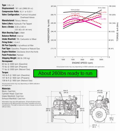

facthunter Posted April 10, 2018 Share Posted April 10, 2018 A direct drive engine needs an adequate thrust bearing in the set up.. A few hundred pounds is not a lot but it has to take it reliably and the bearing near the prop should be equal to the task as well. These days aluminium for the block and head should be seriously considered. The normal flywheel goes of course replaced by the prop . Cubes makes thrust for a low revving direct drive fixed pitch prop or maybe a blower which helps distribute the fuel evenly as well. Low carb position for gravity feed.( Consider.) A long manifold increases carb icing possibility. FOUR cylinder in line motors have extra balance considerations. . Nev Link to comment Share on other sites More sharing options...
