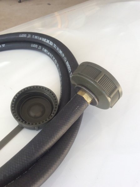

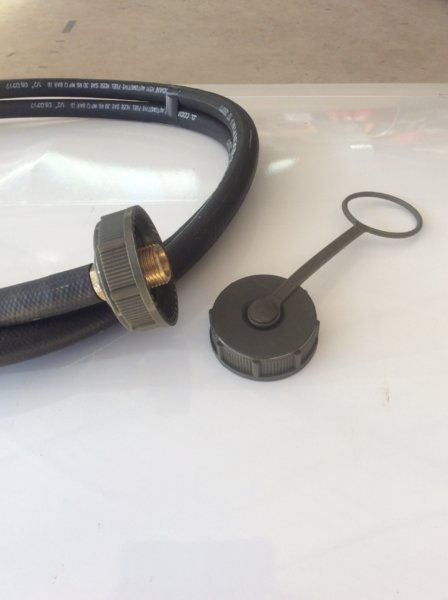

skippydiesel Posted July 17, 2018 Author Share Posted July 17, 2018 Her it is Matt (from an earlier discussion about dodgy fuel hose) a pic of my set up, usually mounted on my service trolley, with 12 V battery: Note: Ground wire (green) with clip Extra long on/of switch wire with switch Non return valve (silver) on bottom of inlet hose. Not essential as pump is self priming. Relatively non restrictive inline filter. Again not necessary if you are using a filter funnel. Holly "knock off" , positive displacement (good lift characteristics), vane petrol pump. To get a "tad" more delivery rate I have since deleted the in line filter and have reverted to a home made filter funnel on the aircraft filler port. Just put Holly pumps into Google and you will get directions to a range of potential suppliers of both the real Holly and the copies.- I purchased mine from a local auto shop specialising in race cars (street & track). I think Super Cheap Auto also do them. 1 Link to comment Share on other sites More sharing options...
skippydiesel Posted July 27, 2018 Author Share Posted July 27, 2018 Update on KISS fuel transfer from 20 l collapsible jerrycan (bladder) to aircraft; Today was the day to try it out. Purchased two new lids to suit jerry. Drilled one to fit 1/2 in spigot Well the good news is that my spigot to cap transplant worked fine - no leaks. Minor bad news - had difficulty getting modified cap to seal - small leak. Cap has no "rubber " gasket may have to find one. Major bad news - a hydraulic engineer could have told me this - my puny 70 kg weight standing on the bladder was not enough to drive the fuel up the two metres of hose into the tank (or at least in the time that I had). 0 for KISS Link to comment Share on other sites More sharing options...

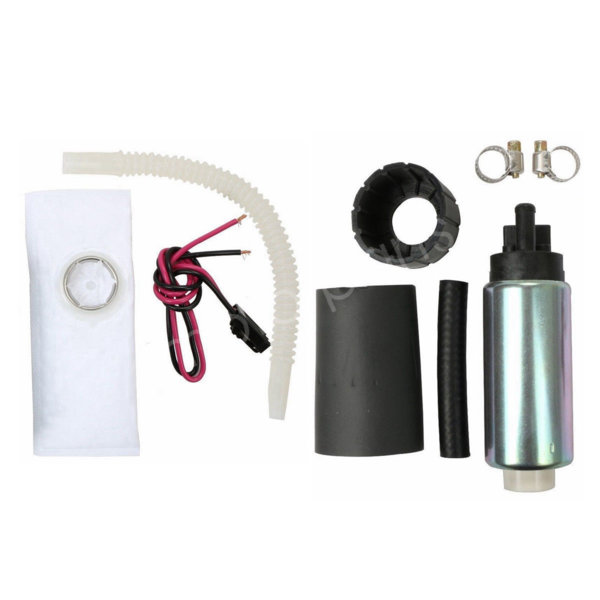

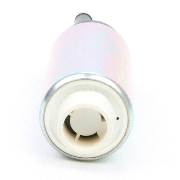

Head in the clouds Posted August 2, 2018 Share Posted August 2, 2018 This would appear to be a good, lightweight and cheap option at $25 - 255LPH FUEL PUMP Set Fits Falcon BA BF 6CY XR6 Turbo XR8 V8 FPV GSS340 In-tank fuel pump normally for fuel injection - at that flow rate it would transfer a 20L jerrycan of fuel in just under five minutes. Just kit it out with a length of 8mm fuel hose with inline filter, a pair of wires with crocodile clips to connect to the battery with an inline rocker switch - and dangle it in the jerrycan of fuel. The pump weighs only 360g so the whole setup would be under half a kilo ... Edit - or if five minutes is too slow for you, you can get a 450L/hr pump for $70 that would transfer the jerrycan of fuel in under 3 mins. Link to comment Share on other sites More sharing options...
