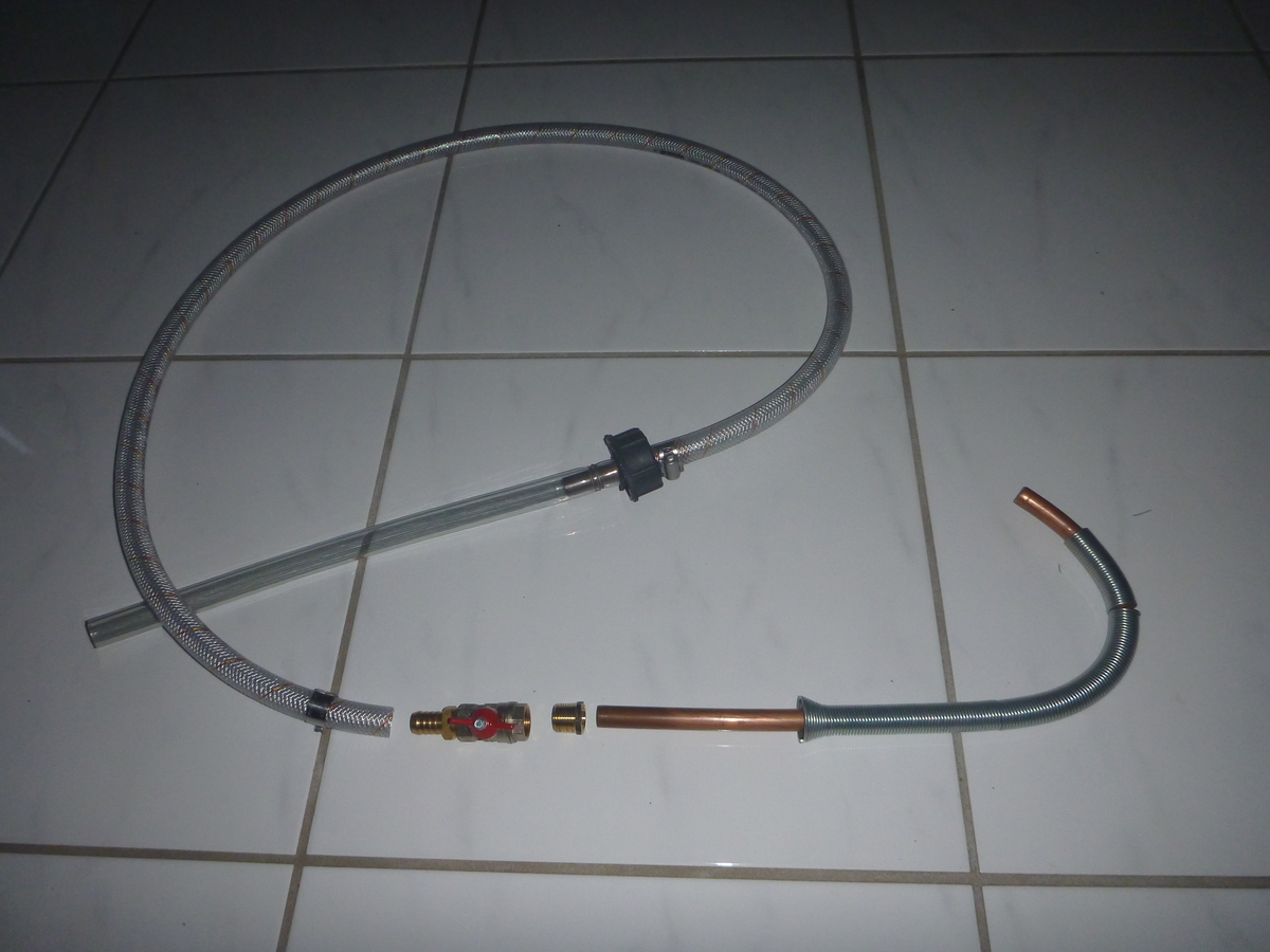

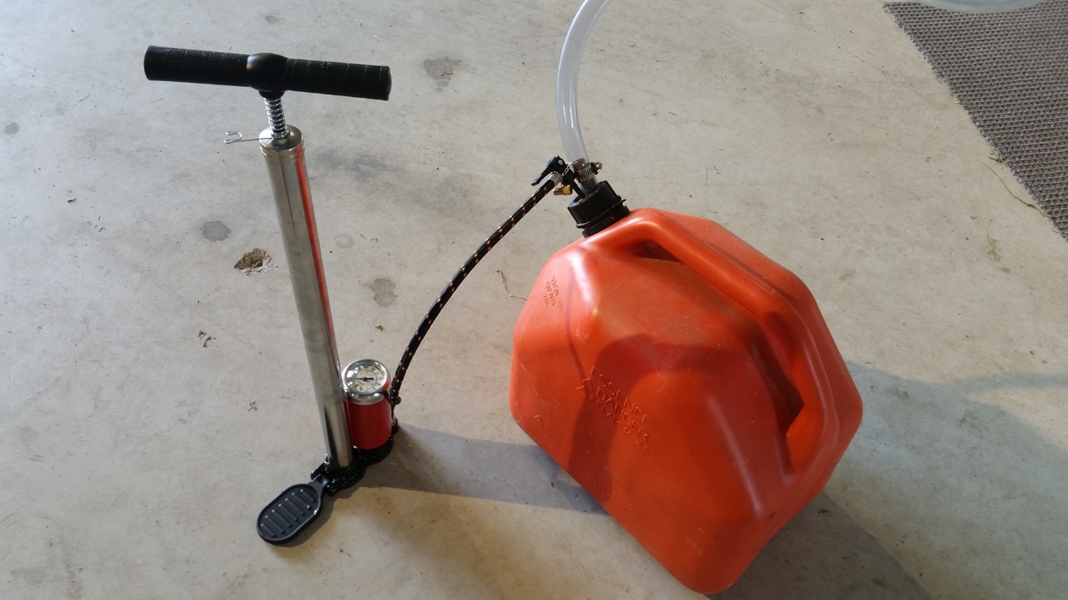

Blueadventures Posted October 17, 2018 Share Posted October 17, 2018 Hi SkippyUpdate. Tonight I finished fabing up the bits to make the cap insert piece (Length of 5/8" copper pipe, cut off bent valve from an old aircraft tube and the brass disc). Just need to clean up and braze or silver solder it the next few days. Then get some hose and give it a try. Cheers [ATTACH=full]61584[/ATTACH][ATTACH=full]61585[/ATTACH][ATTACH=full]61586[/ATTACH] Hi Skippy got a promising trial result today. Filling from a 20 litre fuel jug with 16mm hose from jug up to wing tanks. About 180cm rise and using a hand tyre inflator the fuel flowed easily up. Only problem encountered was some splash back when the jug was almost empty and caused buy a mix of air bubbles and fuel being in line and when it exited the hose into the Mr funnel at the tank fill point. I believe that the pressure in the hose contributed to this matter. Driving home I remembered that the guy who told me about this system does not have a one way valve it the connection to the fuel container. I'll redo Friday or over weekend with the valve removed from the pump connection that way I can control the fuel flow as the container will not be under pressure, just the pump strokes. Cheers Mike Link to comment Share on other sites More sharing options...
skippydiesel Posted October 17, 2018 Author Share Posted October 17, 2018 Hi Skippy got a promising trial result today. ................................................................................ Cheers Mike Hi Mike. Sounds promising although the bubbles/gurgles at the end may represent a rather risky aerosol. Dont blow yourself up. I have further modified my Holly - removed all brackets, to lighten as much as possible and fitted with a rigid black Polly pipe on the inlet side (replacing a hose). The idea is that the pump will stay in the neck of the fuel bladder without having to be held. This will leave my hands free to support bladder and direct fuel flow into aircraft. I plan to try it all out next week by refuelling 40 litres using "ship power"(on board battery) only. I will follow this by hopefully starting the 912 & flying away. If it all works I have an "away" fuelling system that should not spill a drop or bust my back. Link to comment Share on other sites More sharing options...
Blueadventures Posted October 17, 2018 Share Posted October 17, 2018 Hi Mike.Sounds promising although the bubbles/gurgles at the end may represent a rather risky aerosol. Dont blow yourself up. I have further modified my Holly - removed all brackets, to lighten as much as possible and fitted with a rigid black Polly pipe on the inlet side (replacing a hose). The idea is that the pump will stay in the neck of the fuel bladder without having to be held. This will leave my hands free to support bladder and direct fuel flow into aircraft. I plan to try it all out next week by refuelling 40 litres using "ship power"(on board battery) only. I will follow this by hopefully starting the 912 & flying away. If it all works I have an "away" fuelling system that should not spill a drop or bust my back. Absolutely agree, caution will ensure control of delivery so no aerated fuel is delivered, plus grounding of system. Was surprised how little effort was required to lift the fuel. Your system is progressing well and yes it's good not to have to lift fuel jugs. Cheers Link to comment Share on other sites More sharing options...

Blueadventures Posted December 22, 2018 Share Posted December 22, 2018 Hi Skippy Update. Tonight I finished fabing up the bits to make the cap insert piece (Length of 5/8" copper pipe, cut off bent valve from an old aircraft tube and the brass disc). Just need to clean up and braze or silver solder it the next few days. Then get some hose and give it a try. Cheers [ATTACH]37043[/ATTACH] [ATTACH]37041[/ATTACH] [ATTACH]37042[/ATTACH] Today I used the setup and it worked a treat. Removed the valve from the stem valve body so no excessive build up in the container. Just needs a little refinement. Eg earth cable system, and a valve at delivery end and i'll place a curved end nozzle after the control valve to direct into the mister funnel. Fitted in a fly as well. 1 Link to comment Share on other sites More sharing options...
skippydiesel Posted December 22, 2018 Author Share Posted December 22, 2018 Well done BlueA - You've stuck with your concept & it WORKS !!! I understand why you have removed the air valve . I presume that in practice this means you must pump continually to "lift" your fuel??. Perhaps the ability to retain a few psi in the tank might allow you to take a break from pumping. The view out of the cockpit looks a bit like the Sydney Basin ? Link to comment Share on other sites More sharing options...
Blueadventures Posted December 22, 2018 Share Posted December 22, 2018 Well done BlueA - You've stuck with your concept & it WORKS !!! I understand why you have removed the air valve . I presume that in practice this means you must pump continually to "lift" your fuel??. Perhaps the ability to retain a few psi in the tank might allow you to take a break from pumping. The view out of the cockpit looks a bit like the Sydney Basin ? You don't have to keep pumping; pressure remains in the container. Just with the vale you can create too much pressure. I should have got it going months ago. On ting I'll do is extend the pump to cap valve hose so I can have the pump on my step and monitor as I fill the tanks to full for trips, Area is just west of Mackay. Palmyra to Eton area. Low cloud and rain so just stayed local. I made a slight adjustment to the flap and was keen to try. Worked great. Cheers and Merry Xmas. Mike Link to comment Share on other sites More sharing options...
skippydiesel Posted December 22, 2018 Author Share Posted December 22, 2018 You don't have to keep pumping; pressure remains in the container. Just with the vale you can create too much pressure. I should have got it going months ago. On ting I'll do is extend the pump to cap valve hose so I can have the pump on my step and monitor as I fill the tanks to full for trips, Area is just west of Mackay. Palmyra to Eton area. Low cloud and rain so just stayed local. I made a slight adjustment to the flap and was keen to try. Worked great. Cheers and Merry Xmas. Mike I guess I was taken in my the overcast - so typical of the Sydney basin. And to you all the best for Christmas and the New Year Fly Safe Sean Link to comment Share on other sites More sharing options...

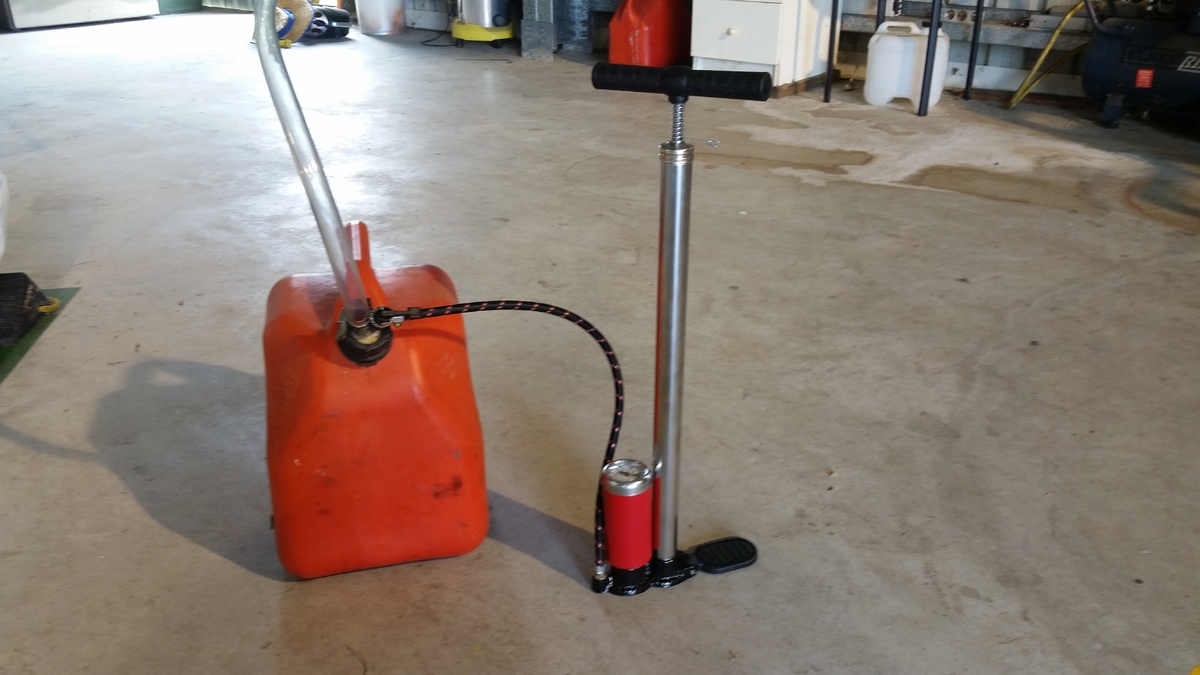

Blueadventures Posted January 5, 2019 Share Posted January 5, 2019 Today I used the setup and it worked a treat. Removed the valve from the stem valve body so no excessive build up in the container. Just needs a little refinement. Eg earth cable system, and a valve at delivery end and i'll place a curved end nozzle after the control valve to direct into the mister funnel. Fitted in a fly as well. [ATTACH]38136[/ATTACH] [ATTACH]38137[/ATTACH] Refining the system a little more. Fitting a valve at the delivery end and a copper pipe bent to direct fuel into filler via Mr Funnel. (Bending spring still on so I can alter the pipe bend radius to suit.) I'll fit heat srink over the valve ends and the copper pipe so no chance of marking wings etc. I'll then attach the earthing system. Cheers Link to comment Share on other sites More sharing options...
skippydiesel Posted January 5, 2019 Author Share Posted January 5, 2019 Looking good. Fuel tank looks like 10 L - correct? What length is the delivery hose? I appreciate pressure will have a bearing but have you worked out an approximate delivery rate? Link to comment Share on other sites More sharing options...
