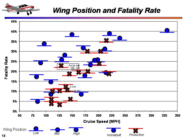

The C172 comes up with lower crash statistics and if flown within its limits may be safer due to lower performance meaning lower impact kinetic energy equating to greater survivabilty. My reading is that the higher performance (and usual avionics) of the C182 will give a performance edge over RA and C150 level aircraft to deal with the Bass Straight flight mission, not that it is the lowest specification plane that can safely cross. The C182 offers top fifth percentile safety capability (that no-one has challenged this leads me to think there is general agreement) for the Bass Straight flight mission as Turboplanner succinctly puts it. The worse crash statistics for the C182 is due to higher average cruise velocities (flight hours need factoring for touring aircraft) and the more hazardous missions pilots attempt with them (My opinion about the situation and why I sought your input and how to meaningfully factor risk data).

IMHO aircraft not in the upper 5th percentile can safety fly Bass Straight, provided correct risk mitigation (as covered in several flights posted) are followed. These measures however mean the flights become an increasingly complicated logisitics exercise. 'Safe' crossing by a Thruster requires shadowing by a rescue helicopter capable of crossing in its own right, so it isn't an option for anything other than a one off challenge (IMHO) and not something I would ever do. IMHO Identifying a top 5th percentile capable aircraft for a given mission is a practicable way to quantify the amount or risk mitigation you will have to apply with any less capable aircraft (that is physically able) to bring the risk down to that level. Arguing about safe planes without defining a mission is meaningless, as the average crash rates show.

I wouldn't see it as a good plane to ditch. Low wing retract with wheels up is generally best.. Big swells are an issue. If you hit a solid wave it's a sudden and damaging stop. Nev
So aircraft configuration for the best ditching survivability is the complete opposite of rough terrain forced landing 034_puzzled.gif.ea6a44583f14fcd2dd8b8f63a724e3de.gif. Is that right? Amphibians are high wing.
Supports putting up with airlines and hiring the appropriate plane at destination!
Any links or references so I can read up on it?
Every ditching can be different, but I have heard that LSA high wing aircraft tend to nose-over and invert leaving you (and much of the rear fuselage) above the water so you can tumble out onto the (briefly) floating wing and not face an underwater escape from your harness and door. I certainly hoped that would be the case when I crossed Bass Strait, (should I encounter a major problem).
