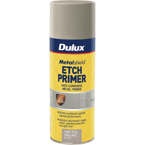

I was going to say Dulux etch primer .... Dulux Metalshield Etch Primer Spraypak
But looking at the msds it's probably a bit toxic for you....
Anyway, I use it on my metalwork and find it works very well.....applys easy and is long lasting and hard wearing.
Quite often this is the only coating I put on as I like the colour and finish. Sometimes I just clear coat straight over it.
Being in a pressure pack, it's handy to grab for a small bracket or whatever...
