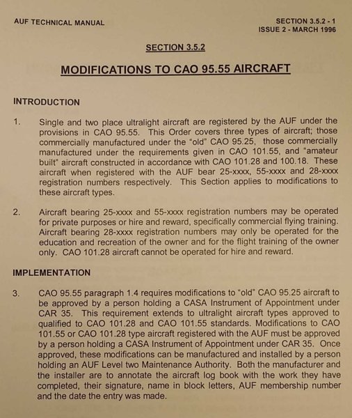

jetjr Posted October 23, 2018 Share Posted October 23, 2018 Sorry but you can modify, the process was strongly debated, some felt its introduction cut back their ability to modify at will. Minor modifications are listed, they require notification only. Major ones require RAA backing and theres a process called MARAP. Theres even a new registration class for modified LSA To retain training ability aircraft must remain approved by manufacturer ie LSA or certificated Reckon you should research it, your getting pretty personal by the way, its a forum, open to everyone and their point of view. You never know they might be correct Link to comment Share on other sites More sharing options...
jetjr Posted October 23, 2018 Share Posted October 23, 2018 Section 6 on the tech manual might interest you, around 10 pages somehow you must have missed. Until this version was released owners were able to conduct major modifications just the same as original builders, now the must have L4 review. Link to comment Share on other sites More sharing options...
Head in the clouds Posted October 23, 2018 Share Posted October 23, 2018 Section 6 on the tech manual might interest you, around 10 pages somehow you must have missed.Until this version was released owners were able to conduct major modifications just the same as original builders, now the must have L4 review. Sorry if you felt my comments were getting personal, I didn't intend that, nor to offend you or anyone else. We do get a lot of 'unfounded opinion' on this forum which is frustrating when the documentation is there for all to consult and get the facts right instead of adopting a position which one feels 'should be the case'. Thank you for the reference though I am well versed in the current Tech Manual including Section 6, the MARAP process etc, as well as the previous versions of the Tech Manual. Just to be sure we're not talking at cross-purposes, 95.10 and 101.28/101.18 aircraft, and their owners were treated differently from each other in the past. Going back to TM Issue 2 (1996) and TM Issue 3 (2007) 95.10 owners could design and implement modifications and repairs at will if they were the owner and had 4 TM(2) paragraphs worth of knowledge in the Design (accurate knowledge of the forces involved, strength of materials, manufacturing processes), Manufacture and Installation (Good planning, workmanship, correct tools) Operation (fully tested and documented) Advice (contract qualified, experienced assistance where required). However, I was referring to the 25, 55 and most specifically 28 reg. series, where you have NOT, historically, been able to modify at will. At least as far back as 1996 modifications have had to be approved by a person holding a CASA Instrument of Appointment under CAR 35. See image - The 19 and the E24 registrations seem to be a can of worms in the TM(3) and I concede I have probably missed the point there. Section 3.5.3 does discuss where modifications have been made to kit or factory-built aircraft, though it doesn't discuss by whom, so I imagine anyone might have done so, including a subsequent owner, as you mentioned. However - although that subsequent owner might have conducted the modification 'at will' they still needed to be issued with an Experimental or Special Certificate of Airworthiness by an 'Approved Person'. That's all very well, and I think we all know those Certificates were being handed out quite freely at one time which resulted in a big mess for some people later on ... BUT (from para 3.a) that Special Certificate of Airworthiness "stops having effect if the aircraft is modified outside of the approval given by the manufacturer ..." (in which case see Section 7.5.4) which then makes it an E24 reg (private ops only) provided it still meets the LSA category regulations. Many of the kit/homebuilts wouldn't have met LSA category in the first place, so where would that leave them? 1 Link to comment Share on other sites More sharing options...
