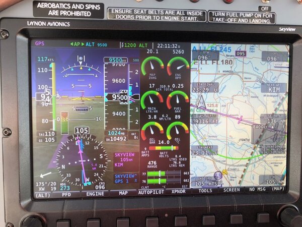

My average fuel burn on a 2-3 hour flight (912ULS) based on tacho time is about 17 lph but steady cruise (112-115 kts IAS at about 3000 feet and 5200-5300 rpm) is about 19 lph.
Rgmwa, this sounds more like what I would expect, although I am confused by 17 & 19 Lph. What Lph you flight plan at?
