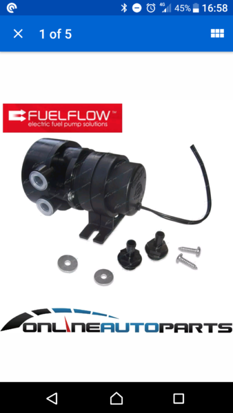

Not sure what you mean by Electric Primer, but I'm guessing you're referring to the electric fuel pump.
If so, my Drifter had a Facet solid state fuel pump available on ebay for $116
Or you can buy various aftermarket versions down to as little as $16.99, I've used a couple of the cheap ones and they have worked well for me.
Why do you need to replace it? Has it stopped working? They are a very simple device that last for thousands of hours usually. They only have two moving parts - an oscillating plunger withing a coil, much like a solenoid, and a non-return valve. If it still makes the usual da-da-da-da noise but doesn't pump fuel it has probably got a problem with the non-return valve, perhaps something stuck in it hence an inline fuel screen (not the fine fuel filter) is best located before the pump to prevent any large matter getting into it and stopping the ball from seating properly. If you look into the inlet end of the pump you can see the ball (often white ceramic or plastic). If you suspect a problem with it you can unscrew the hexagonal barrel and remove the ball and spring and clean it, be sure to make sure it seals again when you screw it back up i.e. use a new fibre washer, O ring, or whatever was there originally.
Hope it helps.
