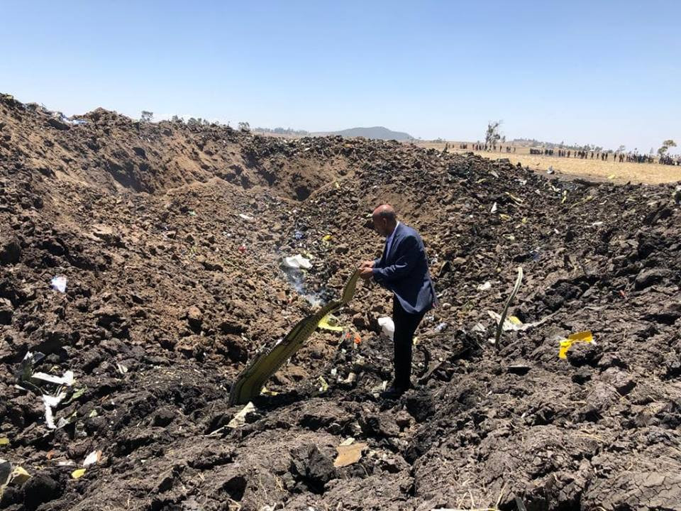

kgwilson Posted March 10, 2019 Share Posted March 10, 2019 An Ethiopian Airlines flight to Nairobi has crashed, leaving no survivors of the 149 passengers and eight crew members aboard, Ethiopia's state broadcaster has said. Key points: A spokesman said the plane crashed on its journey from Addis Ababa The airline is yet to release a statement Up to 157 people were onboard the Boeing 737 when it crashed The crash occurred after the plane experienced an "unstable vertical speed after take-off", Swedish flight-tracking website flightradar24 said. "Data from Flightradar24 ADS-B network show that vertical speed was unstable after take off," the organisation said on Twitter. Flight ET 302, a Boeing 737-800 MAX from Addis Ababa to Nairobi, lost control with air traffic controllers on the ground six minutes after take-off. https://www.abc.net.au/news/2019-03-10/ethiopian-airlines-flight-to-nairobi-crashes-with-157-people/10887840 It is too early to tell what happened but there must now be some serious questions about this model 737. The plane was only 3 months old. Link to comment Share on other sites More sharing options...

biggles Posted March 10, 2019 Share Posted March 10, 2019 An eyewitness told AFP the plane came down in flames. “The plane was already on fire when it crashed to the ground. The crash caused a big explosion,” Tegegn Dechasa recounted at the site littered with passenger belongings, human remains and aeroplane parts around a massive crater at the point of impact. “The plane was in flames in its rear side shortly before the crash. The plane was swerving erratically before the crash.” Link to comment Share on other sites More sharing options...
