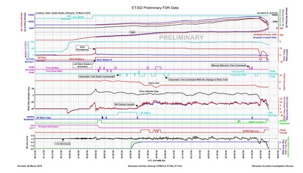

Report just now from ABC that 2 US captains had unexplained nose down pitch immediately after engagement of a/p. Disengagement of auto pilot allowed normal climb to continue. Problem seems greater than Lion Air crash.

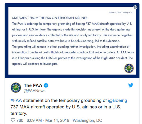

*   *   *    BREAKING NEWS    *   *   *
Donald Trump has grounded all Max 8 and 9 aircraft in the US. - 7 News.

So when the auto pilot is disabled, the mcas system still operates?
Manual control, but not REALLY manual control..... The simple answer is to disable mcas system when auto pilot is disabled?
Also what is the go with the mks system reacting to only one erroneous sensor input? Why actually have multiple sensors and redundancy then?
Pretty horrific thinking the pilots were trying to trying to get the nose up with trim and yoke inputs but the aircraft is driving itself into the deck!

So, if I have understood the video correctly: in the event that this MCAS system is erroneously trimming nose down, for whatever reason, the only workable crew response is to turn off the trim servos with the switches on the centre console, then retrim the aircraft by hand with the manual trim wheels?
All of which supposes the aircraft is at sufficient height, and in a suitable flying attitude, to allow that to be successfully carried out............
Yes, but they have to determine the problem first......

The pilots of the Max 8s were experienced high hours pilots & yet they failed to disable both Autopilot & MCAS systems. A couple of points to ponder are
  1. Why does the MCAS system continue to operate when Autopilot is disengaged? The pilots manually change trim (by switches on the yoke) & MCSA then takes over after 5 seconds to negate their input. They should know this but at the time their mind is in overdrive.
  2. Most of the flying hours of these pilots is sitting there while the autopilot flys the plane. There is probably only 1 takeoff & landing for each 3-5 hours of experience and most of that is assisted. I had more than 150 takeoffs & landings in my last 50 hours.
