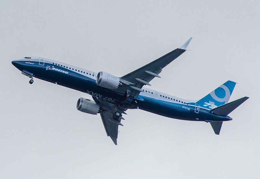

onetrack Posted March 17, 2019 Share Posted March 17, 2019 Below is an excellent dissertation on the 737 MAX's MCAS problems - written straight after the Lion Air crash, late last year. The source of much of the increasing problems with the MAX, is the new engines, which have added a number of potential problem-causing scenarios, particularly related to the bigger engine positioning, and the new design, engine nacelles. Add in AOA or airspeed sensor faults, coupled with the MCAS loop, and you can see where the handling problems are getting beyond pilots, who have not been run through the increased number of fault scenarios, or even how the MCAS works. https://leehamnews.com/2018/11/14/boeings-automatic-trim-for-the-737-max-was-not-disclosed-to-the-pilots/ 2 1 Link to comment Share on other sites More sharing options...

kgwilson Posted March 19, 2019 Author Share Posted March 19, 2019 The design of the 737 in 1966 was never meant to have to deal with such powerful engines. Moving the new engines forward provided only a small correction for the additional weight and thrust with MCAS designed to do the rest. The main competitor, the A320 didn't appear for another 20 years and quickly made inroads into the 737 marketplace. It was a new FBW design with a wider fuselage. It is now the fastest selling narrow body jet airliner with over 6000 firm orders, a position previously held by Boeing which has 5000 orders for the 737 Max. It is understandable why Boeing has persisted with the design being the most successful jet airliner of all time but perhaps a new total redesign would have been a better option given the current issues. The main reason why this did not happen is most likely Cost. Boeing may rue this decision depending on the final outcome of the current investigations 1 Link to comment Share on other sites More sharing options...

Thruster88 Posted March 20, 2019 Share Posted March 20, 2019 The design of the 737 in 1966 was never meant to have to deal with such powerful engines. Moving the new engines forward provided only a small correction for the additional weight and thrust with MCAS designed to do the rest. The main competitor, the A320 didn't appear for another 20 years and quickly made inroads into the 737 marketplace. It was a new FBW design with a wider fuselage. It is now the fastest selling narrow body jet airliner with over 6000 firm orders, a position previously held by Boeing which has 5000 orders for the 737 Max. It is understandable why Boeing has persisted with the design being the most successful jet airliner of all time but perhaps a new total redesign would have been a better option given the current issues. The main reason why this did not happen is most likely Cost. Boeing may rue this decision depending on the final outcome of the current investigations The problem as I understand it is the massive fan diameter on the newer fuel efficient engines. The engines have to be positioned lower further from the centre of drag. This causes a pitch up when thrust is applied. The only clean sheet design that would eliminate this would be a high wing with under slung engines, the public would not like this. The engines on the new 777-x have a similar diameter to the 737 fuselage. 1 Link to comment Share on other sites More sharing options...
Old Koreelah Posted March 20, 2019 Share Posted March 20, 2019 The problem as I understand it is the massive fan diameter on the newer fuel efficient engines. The engines have to be positioned lower further from the centre of drag. This causes a pitch up when thrust is applied... Are you sure, T88? Surely a larger-diameter engine would be mounted higher, to maintain ground clearance. Link to comment Share on other sites More sharing options...
IBob Posted March 20, 2019 Share Posted March 20, 2019 The engines aren't lower. They're moved forward and raised. The first video in message #54, above, does a pretty good job of explaining the relocation of the engines, and the effect/s of that. 1 Link to comment Share on other sites More sharing options...
Thruster88 Posted March 20, 2019 Share Posted March 20, 2019 Are you sure, T88? Surely a larger-diameter engine would be mounted higher, to maintain ground clearance. Yes, all the bypass air(most of the thrust) has to go under the wing, all the newer aircraft have very little clearance. 1 Link to comment Share on other sites More sharing options...
