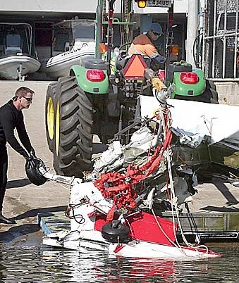

Mr Gash said he was beginning to believe a bird strike was behind the crash.
"We think he hit a big bird and it just came through the cabin.
"I think they were incapacitated very quickly."

Insp Day said police were hoping once the aircraft was recovered, light would be shed on what led to the tragedy.
"At first reports the aircraft has been damaged severely," said Insp Day. "In fact, most of the aircraft framing and cover has been removed leaving only the seats, engine and one steel rail that supports those two items."

Check this out. http://www.goldcoast.com.au/article/2008/03/15/8879_gold-coast-news.html
"Sen-Sgt Kelly said the cause of the crash was yet to be determined.
"At the moment the investigation is at a very early stage," he said.
"The coroner will determine the cause of the accident.
He said a bird strike had not been ruled out.
"There was nothing foreign found in the cockpit -- in fact, there was very little found in the cockpit," said Sen-Sgt Kelly.
"From the wreckage it would appear to be a fast impact at high speed. Both wings are still attached to the plane."
It seems that wings falling off is not the cause.
Perhaps birdstrike, or some other canopy failure causing loss of control
