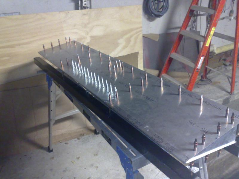

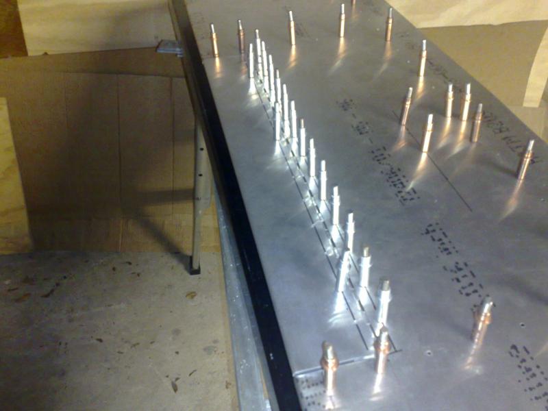

Have only been tinkering since coming back from Oshkosh. We have been helping the third kit builder in our team to catch up with us. The bothers have been working on the engine cowling. i will post some more pictures soon.

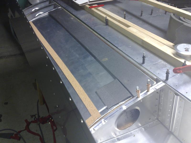

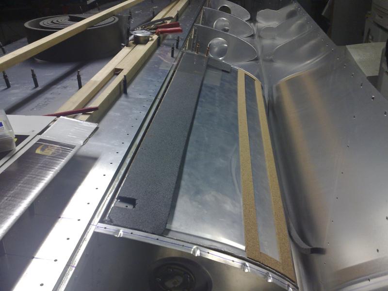

I have finished putting the trim kit into the aileron. and now have the tank fitted into the wing.
[ATTACH]6469.vB[/ATTACH] [ATTACH]6470.vB[/ATTACH]
I have used black Able flex rubber that is used in concrete expansion joints. This fills the gap between the skin and the tank very well. it easily trimmed in thickness with a bread knife.

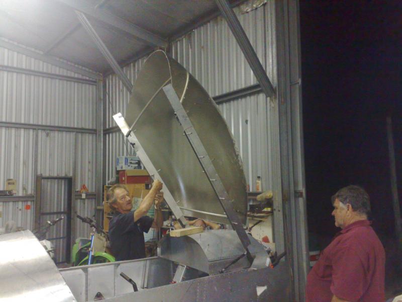

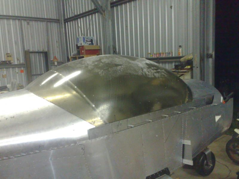

The new 650 canopy has finally arrived. We now can get a move on again and get this thing into the air. I have been working on the intake manifold and the baffle kit for the Corvair. I will post some more pic asap.
We have been working on the third 601 while waiting for our canopy. We used the original canopy on this plane. We will be starting on his wings next.
