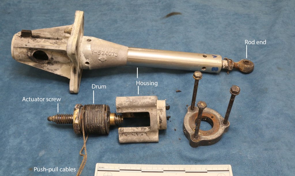

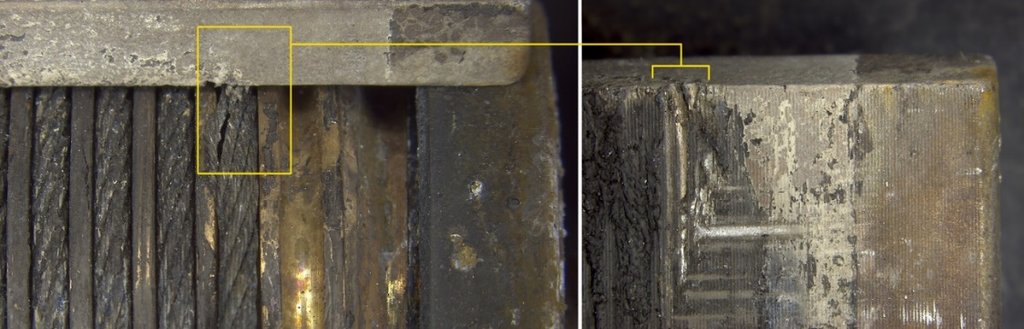

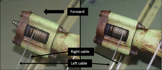

Thruster88 Posted August 20, 2019 Share Posted August 20, 2019 Looks very similar to Essendon, especially the side yaw. I still believe that at Essendon the rudder trim cable could have been pulled early in the impact sequence, the left cable was found broken so some force was applied. The fin structure still intact at this point guided the cable on and off the drum in the normal way until the structure deformed leaving the witness mark in the actuator at the full left rudder trim position. If the the trim was full left prior to take off how did it get there. Why didn't the pilot adjust the trim if he was standing on the right rudder. So many unanswered questions. Link to comment Share on other sites More sharing options...
facthunter Posted August 20, 2019 Share Posted August 20, 2019 The similarity is only the type and that a turnback was involved and they both ended up in the roof of a hangar. One was an engine failure and the other was a mishandled rudder trim situation Both involve managing a yaw and managing energy/drag relationships. This type of aircraft usually relies on auto feather as a turboprop power unit can generate more drag than it gave in thrust IF it's not feathered quickly you are going DOWN and will have acute YAW problems and may get below VMC(a) rapidly where the full rudder will not stop a yaw towards the dead engine which will then be followed by a wing drop and roll inverted and a near vertical nosedive into the ground. As well as getting the dead engine feathered the gear must be retracted as soon as a positive climb is achieved. The plane must also be loaded within the limits of the runway conditions. Wind velocity ,temp, density altitude, obstacle limits runway length limits etc. The plane should be able to fly after V1 (decision speed, but really a point on the runway) Up till that point it should be able to safely stop within the confines of the runway and any over run area available. Nev Link to comment Share on other sites More sharing options...
