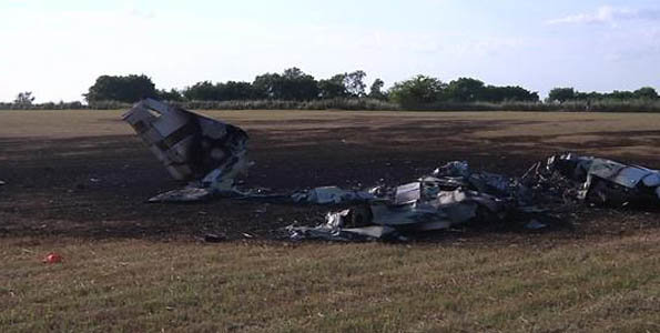

planedriver Posted August 4, 2019 Share Posted August 4, 2019 https://www.bbc.com/news/world-africa-49226128 Very sad outcome for all concerned, as Sling 4 being flown by students from Cape to Cairo crashes. Link to comment Share on other sites More sharing options...

facthunter Posted August 5, 2019 Share Posted August 5, 2019 Just to be clear, it's a support plane not the one the Kids are involved with. and that area looks very suitable (obviously mown) did they lose control? Nev 1 Link to comment Share on other sites More sharing options...
onetrack Posted August 5, 2019 Share Posted August 5, 2019 Yes, that is very puzzling. But the wreckage appears to reflect a stall, leading to an unsurvivable high RoD in a flat spin, ending in a pancake into the ground. The pilot and co-pilot may have potentially survived - but when a full load of fuel catches fire, with stunned or unconscious victims trapped (before any rescuers can reach them), then the end result is what you see. 1 Link to comment Share on other sites More sharing options...

old man emu Posted August 5, 2019 Share Posted August 5, 2019 I agree that it looks like a stall/spin result. And sort of happily, it wasn't the kids who went in. An EFOTO, no doubt and an attempt to turn back seems to be a logical conclusion at this time. In the Ethiopian capital, Addis Ababa, they could not get fuel. "When we eventually got it, the support aircraft started leaking fuel so they couldn't fly with us and only two people - Driaan van den Heever, the safety pilot, and I carried on," Megan said. Link to comment Share on other sites More sharing options...
