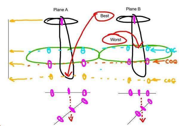

turboplanner Posted August 10, 2020 Share Posted August 10, 2020 A tail wheel aircraft is dynamically unstable. The design comes from the very early times where the fine points of Engineering knowledge weren't what they are today. Cars and trucks of that era often were also dynamically unstable. In the 19th century wagons were built with a wheel at each corner, so the centre of gravity was located within the wheelbase but when an engine and cab were added the tray was just slid backwards overhanging the rear wheels and the early trucks were quite unstable. This was because the centr of gravity was often behind the rear axle, so the downforce was in cantilever. A cantilever load behind the rear axle levers the front axle up, and the mass of the front axle doesn't just disappear up into the air but is added to the rear axle. So the front tyres didn't have the same grip. If you look down on the truck in plan view going around a corner, the centre of gravity behind the rear axles is pushing outwards and if it gets the truck around at enough angle will get it to swap ends. In a tail wheel aircraft the centre of gravity is behind the mains and the moment arm from the CG to the mains is very short, while the moment arm to the tail wheel is very long, and in some cases only a skid is used, other cases the tail wheel is free wheeling. If we disregard wind forces on the control surfaces and just look at mass and undercarriage points, we have a big mass located behind the wheels, and very little side thrust resistance from the tiny tail wheel. So if the aircraft taxis on to a slope down from right to left, the left side of the aircraft is lower than the right and the aft CG will want to turn the aircraft to the right. There is always some undulation in a strip, so this cantilever effect starts to magnify as soon as the CG gets slightly out of line, hence the need to be "ahead of the aircraft". Kinetic energy then kicks in and there's a point where the CG yaws the wheels into an out of control situation. There are some quite large aircraft with fore and aft single wheels or wheelsets, and outrigger balanc wheels under the wings, and this design puts the CG between the wheels and makes the aircraft dynamically stable. The tricycle undercarriage allows the CG to fall inside the wheelbase (CL from wheel to CL rear wheels), a dynamically stable design without the unexpected swing of the taildragger, so much more predictable without the constant threat of a ground loop. 1 Link to comment Share on other sites More sharing options...
facthunter Posted August 11, 2020 Share Posted August 11, 2020 I'd question your second last para. The U2 is like that and is a particularly difficult plane to manage on the ground. The tricycle is the best answer for most pilots as the weight carrying wheels are behind the planes Cof G giving it a natural directional stability at touch down if it's pointing slightly differently from it's direction of travel, UNLESS the forward located nosewheel takes the weight first.. I was trained from the beginning on tailwheel and used mainly 3 pointers. When (nearly) everybody went over to tricycle a lot of "wheelbarrow effect" accidents started to happen, which having always operated from a short strip I couldn't understand as we would try to just get the stall horn before touchdown anyhow. Flying it on would use too much runway. All proves you can't make a fully foolproof plane. Maybe the instruction doesn't emphasis this as much as it should and "fast" Landings can get you into trouble in other ways and it's harder on the plane and brakes as well. Nev Link to comment Share on other sites More sharing options...
turboplanner Posted August 11, 2020 Share Posted August 11, 2020 I'd question your second last para. The U2 is like that and is a particularly difficult plane to manage on the ground. The tricycle is the best answer for most pilots as the weight carrying wheels are behind the planes Cof G giving it a natural directional stability at touch down if it's pointing slightly differently from it's direction of travel, UNLESS the forward located nosewheel takes the weight first.. I was trained from the beginning on tailwheel and used mainly 3 pointers. When (nearly) everybody went over to tricycle a lot of "wheelbarrow effect" accidents started to happen, which having always operated from a short strip I couldn't understand as we would try to just get the stall horn before touchdown anyhow. Flying it on would use too much runway. All proves you can't make a fully foolproof plane. Maybe the instruction doesn't emphasis this as much as it should and "fast" Landings can get you into trouble in other ways and it's harder on the plane and brakes as well. Nev I just wanted to show the difference in the underlying dynamics, one inherently stable, the other inherently unstable. Putting the flying surfaces back on my dynamically stable machine, there should NEVER be a situation where you land a tricycle undercarriage nosewheel first, so you should never experience the wheelbarrowing and dynamic slam dunk, but................... On this site some years ago a well known instructor was teaching students to point the nose down for landing and use the yoke to lose height and the throttle to adjust speed, and defended it even as students were bouncing and writing off nose wheels. You are supposed to land on the same two wheela as you do with a tail dragger, so the approach is tail down, using the yoke to adjust speed and the throttle to adjust altitude, so you will be landing on the mains and the yoke will be coming back until it's all the way back and the nose wheel gently touches at slow speed. I'm not a promoter of learning to fly by correspondence, so if you are doing something different, talk to your instructor and get him/her to teach you in real time with real inputs. The U2 was an exception in that it landed long and fast and the stabiliser wheels were fitted by a chase car after it had landed. The link shows Area 51 and Groom Lake. You can see the U2 and Oxcart tracks off the end of the runway and following a circular pattern around the lake. The planes I was thinking of were heavy bombers where it must have had some attraction. https://commons.wikimedia.org/wiki/File:Area_51_Groom_Lake.jpg Link to comment Share on other sites More sharing options...
facthunter Posted August 11, 2020 Share Posted August 11, 2020 In all fairness the U 2 s great wingspan makes it directionally "different" also with inertia effects of the wings but making it like a pushbike requires it to lean. Early planes were quite high to clear the large props of the day and consequently, with narrow undercarriages, steered like a double decker bus and used steering techniques that would seem strange to us today if we didn't analyse the situation. Ie a wing rising is lowered by turning away from the rising wing thus "tipping" the plane back level. Also planes were not on strips but all over fields so could take the "into wind" option. On windy days also they often stayed in the hangar, and a lot of the flying was done in the mornings and evenings. This was well documented at the time and a lot of this material is very interesting to students of skills and thrills of aviation. Plenty of the very basic U/Ls are not very good with coping with winds. A slow stall speed and light wing loading means wind and gust sensitivity is part of the equation... Nev 1 Link to comment Share on other sites More sharing options...
