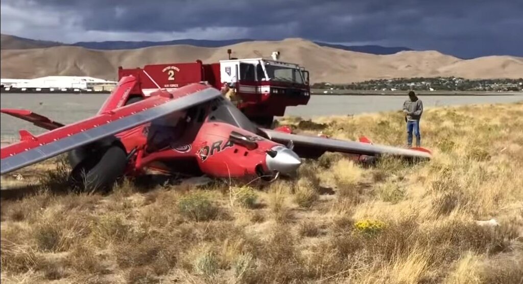

He was really optimistic in opening up the power when you could see the wind was already lifting his left wing. Your ailerons are useless until you have probably 30-40 kts flowing over them.  He did mention 30 kt gusting winds, then calm, and looking into those storms in the background, plus the virga off higher storms in some early frames, I'd say he was a microburst victim. Really feel for him.  Many of us have had similar loss of directional control but been lucky to have sufficient speed to be able to fly away - albeit away from the strip - and lived to fight another day. One thing I noticed was that he was more worried about the 'tower' approval than making a 'safer' takeoff. The tower usually can't see whether you are taking off or landing 20-30 degrees 'accross' the runway, and wouldn't care, provided you didn't conflict with a parallel runway traffic.  Whatever it takes with high wing taildraggers!!

was more then just a low-speed nosedive, the whole aircraft rolled
Ive seen video of Mike bouncing Draco off bumps to test the suspension (which has snapped off) it was built very tough,
everything re-enforced and machined from billet.
Link to post
 Yes, they are not designed to crash without damage.  (like  Jabiru??)   Plenty of airliners break in half in what looks like a fairly benign event (unless you are in it) . That one seems a bit brittle as you say. Nev
Link to post
Sorry, I can't agree with your opinion. The aircraft didn't roll, it nosedived lightly, then did a quarter roll to the left, whereupon both wings and the LH landing gear broke off, and the fuselage roll stopped.
I'm of the opinion he wasn't really going all that fast, when he ran off the runway and nosedived (maybe 35kts?), and I would have though the wing attachment strength would have been higher than what it is.
The starboard wing fracturing downwards and breaking right off, with a simple quarter roll to the left, appears to make the wing strength look weak.
I know the direction of the fracturing is being caused by some serious negative G forces, but I would have expected the starboard wing at least, to be able to handle that quarter roll.

I would not say the wings have broken off, one strut has collapsed and the other has broken most likely due to the undercarriage having been torn from the aircraft sideways. The wings are still bolted to the fuselage.  I missed the nose dive bit. It is no wonder journalist's struggle with this stuff.

No struts.
You are so right, it's no wonder journalist's struggle with this stuff. I have seen a million pictures of draco, just assumed being high wing that it was strutted.
Well, perhaps it wasn't a nose dive, in the true sense of the word. But when he was going sideways, and the port undercarriage leg collapsed, he certainly nosedived enough into terra firma, to reduce the prop to stubs.
I guess the lack of struts on the wings is a big factor in why they broke so rapidly.

Low speed STOL doesn't need to be "Normally" able to handle high negative G.    Strut or no strut the structure would have to achieve the design structural loads. A strut makes the wing more stiff but a normal strut doesn't work particularly well in a negative G situation. Having BOTH wings fail at the point of attachment to the fuselage without any obvious damage otherwise , shows a design weakness pretty clearly. Nev
