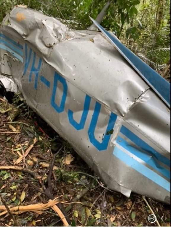

Missing NSW plane found crashed in forest west of Coffs Harbour

These kind of accidents makes me angry.  Marginal VFR and high terrain....
ADSB track disappears 1nm west of Mount Moombil
[ATTACH]41343[/ATTACH] [ATTACH]41344[/ATTACH]
Yes looking at the last radar track on it, it was doing 165kts at 3200 ft, pretty sad when some of the terrain is 4,000 ft.
You would at least think to slow down a little if you were starting to get boxed in.
Nasty piece of country with some very nasty weather possibilities there to even contemplate a direct route. Coffs has weather on radar and can give an advisory for transiting Aircraft.
Lots of conjecture but ultimately down to the PIC.
Yes, much too fast to respond to terrain ahead of you, especially if it is just visible through cloud & or drizzle.  Why?  -  because the refraction of light by the water droplets creates an illusion that the terrain is further away than it really is.  So, a combination of higher than safe speed, plus the illusion, can mean any last second turn may still be too late.
What I've seen in almost every case where a pilot tucks in too close under a cloud base, particularly if it is also drizzling, they will fly into a lower patch of cloud. The usual reaction is to push the nose down, rather than decrease power and lose height over a shorter distance - all of which just increases the speed, and decreases the margin should you need to turn away from terrain. It creates a scary feeling and certainly spooks most pilots.
 One of the very 1st things that I teach pilots on a low level training course is, (before going <500ft agl), to slow down via power reduction, get some flap extended perhaps, trim the aircraft to a safe manoeuvring speed - and then use power only for descent/climb from there. All lower level, limited visibility manoeuvring should be via power only.  Everything will need a power change - climb/descent/turns.

 It used to be called "scud running"  (under low cloud and peering through mist at low speeds) Don't go there.
        When you are fully VFR the LSALT (lowest SAFE  altitude for that area, sector, track and distance) has little meaning (or you'd never land VFR at Cairns. Whenever you're IMC the LSALT and a corresponding accurate knowledge of where you are is the main thing you use to ensure you don't hit rocks in the sky. Nev
