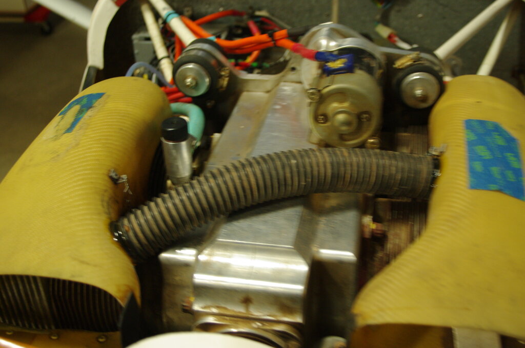

Bruce Tuncks Posted December 2, 2019 Author Share Posted December 2, 2019 Keenaviator, thanks for your reply... please tell us more about what you have done. Just today, I have put a 32mm ribbed hose between the 2 ducts, as suggested by oldK who was right about how the difference between the RHS and LHS ducts should be measured. The measurement showed 45mm of water head difference. Tomorrow I will fly with a connecting duct in place. My hope is that it will equalize things . Link to comment Share on other sites More sharing options...

Thruster88 Posted December 2, 2019 Share Posted December 2, 2019 Keenaviator, thanks for your reply... please tell us more about what you have done. Just today, I have put a 32mm ribbed hose between the 2 ducts, as suggested by oldK who was right about how the difference between the RHS and LHS ducts should be measured. The measurement showed 45mm of water head difference. Tomorrow I will fly with a connecting duct in place. My hope is that it will equalize things . Bruce I hope this works for you but the turbulence, drag caused by the 32mm holes in the duct might reduce total airflow. Just a thought. Link to comment Share on other sites More sharing options...
Yenn Posted December 3, 2019 Share Posted December 3, 2019 The turbulence caused by the holes would be minimal as there is flow through them from low to high, but should be little flow across them. I wait to hear what happened. Link to comment Share on other sites More sharing options...
Bruce Tuncks Posted December 3, 2019 Author Share Posted December 3, 2019 Today I tried the ribbed hose connecting the 2 ducts. I took a picture of how it looks. I reckon it worked well! The manometer ( measuring between the ducts ) showed about 12mm difference, well down from the 45mm difference before the connecting hose. The day was cool, ambient=18 degrees and overcast. On climb, T1=128 T3=139 ( the cooler RHS) T2=153 and T4=151 ( the warmer LHS ) There are a few other things to do... 1. do the test again on a hotter day... adding 17 degrees for a 35 degree day puts that T2 at 170 degrees. 2. putting a deflector in front of no1 cylinder to stop it being so cool 2 Link to comment Share on other sites More sharing options...

Yenn Posted December 4, 2019 Share Posted December 4, 2019 Bruce you are just a young bloke. I hope you get it all where you want it. It appears that the left bank always runs hotter than the right with Jabs, probably something to do with the rearward position of the inlet. Good cooling depends upon the air flow being close to the fins. Anywhere air can flow without going between the fins reduced the efficiency. Lycomings usually have ducting close to the fins beneath the cylinders to stop air exiting directly downwards and force it around the lower part of the cylinder. 1 Link to comment Share on other sites More sharing options...
